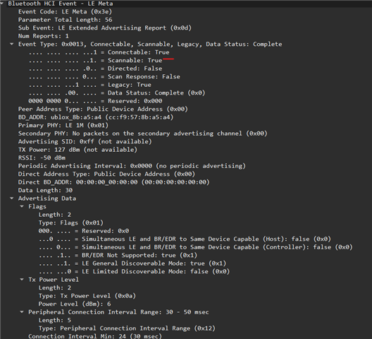

Basically we have a software application that can scan over bluetooth for devices designed to connect to it (done via prefix in device name) which is designed using the QT Framework. These devices are filtered and added to the program and displayed in a list. The user can then select a device and connect to it. If I disable CODED PHY and set the Extended Advertising and Scanning settings to: Scan and Advertising on 1Mbps, Extended advertising disabled , then the device is able to be identified and added to the list in the program.
Further, sniffing via WireShark and using the Windows Bluetooth Virtual Sniffer, I am able to scan with our application and see the following in WireShark (marked as scannable:

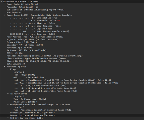

However, enabling CODED PHY results in the device becoming unscannable. Explicitly, I have set the CODED implementation to: Scan and advertising on 1Mbps, CODED secondary. Enabling this, the software is not able to identify the device.  I have confirmed this with a series of debug prints that just prints all the devices it is able to identify. Further checking WireShark, it seems that the "scannable" status is set to false:

    Note that you can't have extended, connectable and scannable. All extended connectable, are non-scannable. ref
    https://infocenter.nordicsemi.com/topic/com.nordic.infocenter.s140.api.v7.3.0/group___b_l_e___g_a_p___a_d_v___t_y_p_e_s.html
  • Hi  ,
    Thank you for the response and the info on extended connectable devices. I was not aware of this, but it is also defined in the core specification guide in section 2.3.1.5. It seems you are correct about what I expect vs what actually happens, and this case what actually happens is that with extended advertising enabled the device is not scannable, but is connectable.

    Looking at section 2.3.1.6 of the core specification, and the Extended Advertising Header in the trace, the Advertising Mode is set to "Connectable Non-scannable" with "Connectable Undirected" as the event type (if I have read this correctly):

  • Hi!
    Scannable means that the scanner can send a scan request.
    Connectable means that the scanner can send a connect request.
    Are you using U-Blox NINA-B31 BLE for both the advertiser and scanner?
    I'm not familiar with QT, but maybe it does not support CODED PHY and Extended Advertising PDUs. These was introduced in Bluetooth 5.0

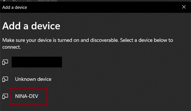

    I am only using the B31 module as an advertiser, and my desktop pc as a scanner. My PC uses a standard microsoft bluetooth module and I can at least scan for devices and have the scan response show the B31 dev kit with CODED PHY enabled:
    This could very well be a limitation of QT, and maybe a way around it would be to make an adaptor with a NINA B3 module that scan scan for CODED PHY enabled devices.
