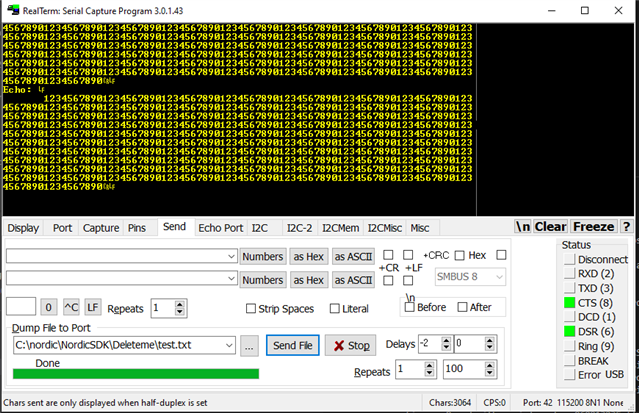

I currently have a project where i send and receive commands over UART to another chip.  When i receive a message over UART,  a callback is  triggered and I continuously read the serial terminal using  "uart_fifo_read(uart_dev_test, &c, 1) " until the end of the line is found.  Why is it that when the when the buffer reaches over 300 bytes, i seem to miss characters over the UART line?
static char serial_response[1000];
void serial_cb(const struct device *dev, void *user_data)
    if (!uart_irq_update(uart_dev_test))
        return;
    uint8_t c;
    uart_fifo_read(uart_dev_test, &c, 1);
    rx_buf[0] = c;
    // Check to see if buffer is full
    if (((strlen(serial_response) + strlen(rx_buf)) > 1000))
        LOG_WRN("Response buffer full");
    else
        strcat(serial_response, rx_buf);
    clearCharArray(rx_buf, sizeof(rx_buf));
    if ((c == ASCII_NEW_LINE || c == ASCII_CARRIAGE_RETURN))
       // Do something
