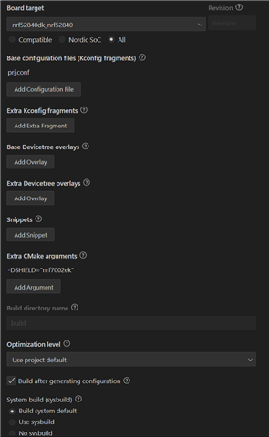

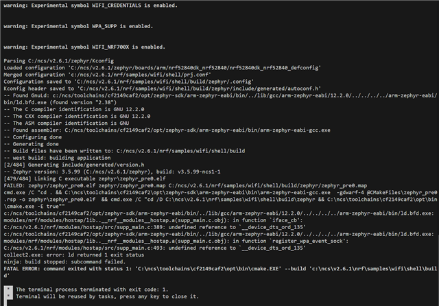

Hi, I'm using v2.7 toolchain  and v2.61 sdk, I tried with both wifi sta and wifi shell example, both failed to build when CONFIG_WPA_SUPP=y, if I comment out this config, then it build successful, but won't function properly.
this is the error message:
and the device tree generated is
 *   134 /soc/spi@4002f000
 *   135 /soc/spi@4002f000/nrf700x-spi@0
Any help would be greatly appreciated.
