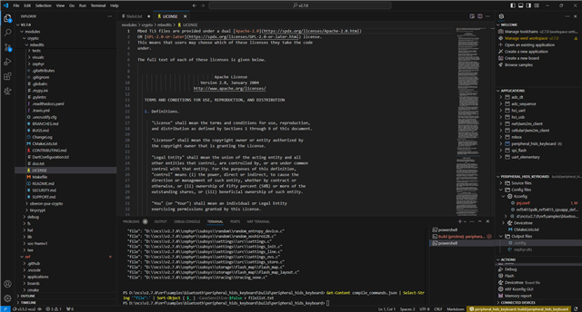

    Unfortunately the software bill of materials (sbom) is currently not working. The tool should generate a list of licenses used by the application as described here:
    https://docs.nordicsemi.com/bundle/ncs-latest/page/nrf/scripts/west_commands/sbom/README.html

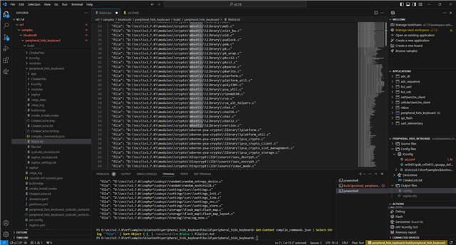

    While waiting for the sbom tool to do this automatically, the only solution for now is to do this manually, this should be possible like below. I am using the peripheral_hids_keyboard as an example application here:
    1. Build application with your preferred configuration and overlays
    1. Open the file in build/compile_commands.json and search for "file": You can use the following command in Windows powershell to find all files and order the files (if Linux you can use "cat build/compile_commands.json | grep "\"file\":" instead)":
    Get-Content compile_commands.json | Select-String '"file":' | Sort-Object { $_ } -CaseSensitive:$false
    1. This will give you a list of files that will be compiled as part of the application, and their locations. Based on this it should be possible for you to select the Git projects you need to check. When I tried this with the hid keyboard sample, the list of repositories I got the following output:
    I could then see that for instance mbedtls was used, so I went to the mbedtls source to check out the license:
    You would then have to do the same for other repositories based on the file list.

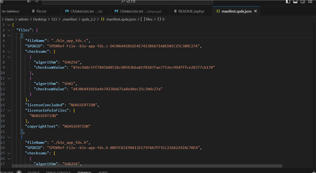

  • Thank you for your reply.
    If I understand correctly, what we can currently do is manually list the files used in the project and trace back the license information through the list.
    So, how can we create a data structure like a .json file?
    The image and attachment below show the results I tried to create using Microsoft.SBOMTool. It seems to require the following information. How can we obtain these details?

            "SPDXRef-File--pca10028-s130-armgcc-Makefile-C1E6E2A79563D69B5E9E781B76AAE167E7D5F3AD",
            "SPDXRef-File--pca10028-s130-arm5-no-packs-RTE-Device-nRF51422-xxAC-arm-startup-nrf51.s-9FE0BA4BA0964F4BF993E4222287B905B66D44B8",
            "SPDXRef-File--pca10028-s130-arm4-ble-app-uart-pca10028-s130.uvproj-2E058F89B2E3A47E1A9928DC1295EAFE283F667D",
            "SPDXRef-File--ble-app-fds.c-D4306441016E4E7423B6671A8ED4EC25C30DC27A",
            "SPDXRef-File--pca10028-s130-iar-ble-app-uart-pca10028-s130.ewp-C9393E2B900E56321BC65BD45CC2B4E73028D6EC",
            "SPDXRef-File--pca10028-s130-config-sdk-config.h-42B96FB2E036C69DFC693A03346829062876C2DD",
            "SPDXRef-File--pca10028-s130-arm5-no-packs-RTE-Device-nRF51422-xxAC-arm-startup-nrf51.s.0000-B1F0B339E411BFDD3AB0947F2B7E9CA316380016",
            "SPDXRef-File--pca10028-s130-arm5-no-packs-ble-app-uart-pca10028-s130.uvguix.admin-24B8A973A6EF63F3AA6F4E631CC969882C1977F9",
            "SPDXRef-File--ble-app-fds.h-8B97CB3190413E175F8A7FF5CC236A2292AC70EA",
            "SPDXRef-File--settings-ble-app-uart.wsdt-5037D45107CDCB5610633F6363249E67165ED3F2",
            "SPDXRef-File--pca10028-s130-config-sdk-config.h-RF160434.TMP-26B71542FB1622F70D73F0B81C3C974B1A7AC2B4",
            "SPDXRef-File--pca10028-s130-arm5-no-packs-RTE-Device-nRF51422-xxAC-system-nrf51.c-3862D53B08CCAA649199E00F5235A5EC63053A1D",
            "SPDXRef-File--pca10028-s130-arm5-no-packs-ble-app-uart-pca10028-s130.uvguix.Hugo-422B5F72C9246D73ADC8A1910BFF0D8E153489E4",
            "SPDXRef-File--ble-app-uart.c-15602B281283E75749B98A95D35EF5BA113FCA33",
            "SPDXRef-File--at-cmd.c-75D5C2B21CA336A520ADEE38C5EA88FE0DCE4E41",
            "SPDXRef-File--pca10028-s130-iar-ble-app-uart-iar-nRF5x.icf-C50CEAC85C6A4D932C655CC8A53D21A35505995D",
            "SPDXRef-File--pca10028-s130-armgcc-ble-app-uart-gcc-nrf51.ld-A455E93127DE59DBFF1CB5AC9F49305DAA778FF6",
            "SPDXRef-File--pca10028-s130-arm5-no-packs-JLinkSettings.ini-68D5748580031A4D280E0C555CDA85AA948AA61D",
            "SPDXRef-File--pca10028-s130-arm4-ble-app-uart-pca10028-s130.uvopt-30963FFB1B6EC75E7D105EA0E492FAD7A009550E",
            "SPDXRef-File--ble-app-dfu.h-48E1A66888C4FAA03909FF568D29F0D21138E3F7",
            "SPDXRef-File--pca10028-s130-config-sdk-config.h-RF2ab247e.TMP-42B96FB2E036C69DFC693A03346829062876C2DD",
            "SPDXRef-File--pca10028-s130-arm5-no-packs-RTE-Device-nRF51802-xxAA-system-nrf51.c-4D69251A13A9E27DAD739795D7813C2F07F9264D",
            "SPDXRef-File--pca10028-s130-arm5-no-packs-ble-app-uart-pca10028-s130.uvprojx-988E58AD8A96AA60F4498F3101C681C9FD9214C6",
            "SPDXRef-File--main.c-D4D5DFDBE80E1072366ED3376CBD8D59338369E3",
            "SPDXRef-File--ble-app-config.h-519F7A008740606E562A4867A487E8BC8B1352B1"
      "externalDocumentRefs": [],
      "relationships": [
          "relationshipType": "DESCRIBES",
          "relatedSpdxElement": "SPDXRef-RootPackage",
          "spdxElementId": "SPDXRef-DOCUMENT"
      "spdxVersion": "SPDX-2.2",
      "dataLicense": "CC0-1.0",
      "SPDXID": "SPDXRef-DOCUMENT",
      "name": "WB100N 1.0.2",
      "documentNamespace": "https://spdx.org/spdxdocs/sbom-tool-2.2.7-082996a9-6ea3-4dd8-a7e9-74ca6a2eee28/WB100N/1.0.2/ZwOZ0Crk-UGGXyJx5VZ0QQ",
      "creationInfo": {
        "created": "2024-09-09T09:42:31Z",
        "creators": [
          "Organization: OPTO-SENSOR",
          "Tool: Microsoft.SBOMTool-2.2.7"
      "documentDescribes": [
    Before you can run any sbom, manually or automatic, you first need to build the project. The files required are in the build folder.
    Kenneth
  • Yes, I have also done building a list of files.
    So after completing these steps, how can I create a .json file?
    PS C:\Users\admin\ncs\v2.7.0\nrf\samples\bluetooth\peripheral_uart\build_1\peripheral_uart> Get-Content compile_commands.json | Select-String '"file":' | Sort-Object { $_ } -CaseSensitive:$false
      "file": "C:\\Users\\admin\\ncs\\v2.7.0\\modules\\crypto\\tinycrypt\\lib\\source\\aes_decrypt.c"
      "file": "C:\\Users\\admin\\ncs\\v2.7.0\\modules\\crypto\\tinycrypt\\lib\\source\\aes_encrypt.c"
      "file": "C:\\Users\\admin\\ncs\\v2.7.0\\modules\\crypto\\tinycrypt\\lib\\source\\cmac_mode.c"
      "file": "C:\\Users\\admin\\ncs\\v2.7.0\\modules\\crypto\\tinycrypt\\lib\\source\\utils.c"
      "file": "C:\\Users\\admin\\ncs\\v2.7.0\\modules\\debug\\segger\\SEGGER\\SEGGER_RTT.c"
      "file": "C:\\Users\\admin\\ncs\\v2.7.0\\modules\\hal\\nordic\\nrfx\\drivers\\src\\nrfx_gpiote.c"
      "file": "C:\\Users\\admin\\ncs\\v2.7.0\\modules\\hal\\nordic\\nrfx\\drivers\\src\\nrfx_nvmc.c"
      "file": "C:\\Users\\admin\\ncs\\v2.7.0\\modules\\hal\\nordic\\nrfx\\drivers\\src\\nrfx_ppi.c"
      "file": "C:\\Users\\admin\\ncs\\v2.7.0\\modules\\hal\\nordic\\nrfx\\drivers\\src\\nrfx_uarte.c"
      "file": "C:\\Users\\admin\\ncs\\v2.7.0\\modules\\hal\\nordic\\nrfx\\helpers\\nrfx_flag32_allocator.c"
      "file": "C:\\Users\\admin\\ncs\\v2.7.0\\modules\\hal\\nordic\\nrfx\\helpers\\nrfx_gppi_ppi.c"
      "file": "C:\\Users\\admin\\ncs\\v2.7.0\\modules\\hal\\nordic\\nrfx\\mdk\\system_nrf52.c"
      "file": "C:\\Users\\admin\\ncs\\v2.7.0\\nrf\\drivers\\mpsl\\clock_control\\nrfx_clock_mpsl.c"
      "file": "C:\\Users\\admin\\ncs\\v2.7.0\\nrf\\drivers\\mpsl\\flash_sync\\flash_sync_mpsl.c"
      "file": "C:\\Users\\admin\\ncs\\v2.7.0\\nrf\\lib\\boot_banner\\banner.c"
      "file": "C:\\Users\\admin\\ncs\\v2.7.0\\nrf\\lib\\dk_buttons_and_leds\\dk_buttons_and_leds.c"
      "file": "C:\\Users\\admin\\ncs\\v2.7.0\\nrf\\lib\\multithreading_lock\\multithreading_lock.c"
      "file": "C:\\Users\\admin\\ncs\\v2.7.0\\nrf\\samples\\bluetooth\\peripheral_uart\\build_1\\peripheral_uart\\zephyr\\isr_tables.c"
      "file": "C:\\Users\\admin\\ncs\\v2.7.0\\nrf\\samples\\bluetooth\\peripheral_uart\\build_1\\peripheral_uart\\zephyr\\misc\\generated\\configs.c"
      "file": "C:\\Users\\admin\\ncs\\v2.7.0\\nrf\\samples\\bluetooth\\peripheral_uart\\src\\main.c"
      "file": "C:\\Users\\admin\\ncs\\v2.7.0\\nrf\\subsys\\bluetooth\\controller\\crypto.c"
      "file": "C:\\Users\\admin\\ncs\\v2.7.0\\nrf\\subsys\\bluetooth\\controller\\ecdh.c"
      "file": "C:\\Users\\admin\\ncs\\v2.7.0\\nrf\\subsys\\bluetooth\\controller\\hci_driver.c"
      "file": "C:\\Users\\admin\\ncs\\v2.7.0\\nrf\\subsys\\bluetooth\\controller\\hci_internal.c"
      "file": "C:\\Users\\admin\\ncs\\v2.7.0\\nrf\\subsys\\bluetooth\\host_extensions\\host_extensions.c"
      "file": "C:\\Users\\admin\\ncs\\v2.7.0\\nrf\\subsys\\bluetooth\\services\\nus.c"
      "file": "C:\\Users\\admin\\ncs\\v2.7.0\\nrf\\subsys\\mpsl\\fem\\api_init\\mpsl_fem_api_init.c"
      "file": "C:\\Users\\admin\\ncs\\v2.7.0\\nrf\\subsys\\mpsl\\init\\mpsl_init.c"
      "file": "C:\\Users\\admin\\ncs\\v2.7.0\\nrf\\subsys\\partition_manager\\flash_map_partition_manager.c"
      "file": "C:\\Users\\admin\\ncs\\v2.7.0\\zephyr\\arch\\arm\\core\\cortex_m\\__aeabi_read_tp.S"
      "file": "C:\\Users\\admin\\ncs\\v2.7.0\\zephyr\\arch\\arm\\core\\cortex_m\\cpu_idle.c"
      "file": "C:\\Users\\admin\\ncs\\v2.7.0\\zephyr\\arch\\arm\\core\\cortex_m\\exc_exit.c"
      "file": "C:\\Users\\admin\\ncs\\v2.7.0\\zephyr\\arch\\arm\\core\\cortex_m\\fault.c"
      "file": "C:\\Users\\admin\\ncs\\v2.7.0\\zephyr\\arch\\arm\\core\\cortex_m\\fault_s.S"
      "file": "C:\\Users\\admin\\ncs\\v2.7.0\\zephyr\\arch\\arm\\core\\cortex_m\\fpu.c"
      "file": "C:\\Users\\admin\\ncs\\v2.7.0\\zephyr\\arch\\arm\\core\\cortex_m\\irq_init.c"
      "file": "C:\\Users\\admin\\ncs\\v2.7.0\\zephyr\\arch\\arm\\core\\cortex_m\\irq_manage.c"
      "file": "C:\\Users\\admin\\ncs\\v2.7.0\\zephyr\\arch\\arm\\core\\cortex_m\\isr_wrapper.c"
      "file": "C:\\Users\\admin\\ncs\\v2.7.0\\zephyr\\arch\\arm\\core\\cortex_m\\prep_c.c"
      "file": "C:\\Users\\admin\\ncs\\v2.7.0\\zephyr\\arch\\arm\\core\\cortex_m\\reset.S"
      "file": "C:\\Users\\admin\\ncs\\v2.7.0\\zephyr\\arch\\arm\\core\\cortex_m\\scb.c"
      "file": "C:\\Users\\admin\\ncs\\v2.7.0\\zephyr\\arch\\arm\\core\\cortex_m\\swap.c"
      "file": "C:\\Users\\admin\\ncs\\v2.7.0\\zephyr\\arch\\arm\\core\\cortex_m\\swap_helper.S"
      "file": "C:\\Users\\admin\\ncs\\v2.7.0\\zephyr\\arch\\arm\\core\\cortex_m\\thread.c"
      "file": "C:\\Users\\admin\\ncs\\v2.7.0\\zephyr\\arch\\arm\\core\\cortex_m\\thread_abort.c"
      "file": "C:\\Users\\admin\\ncs\\v2.7.0\\zephyr\\arch\\arm\\core\\cortex_m\\vector_table.S"
      "file": "C:\\Users\\admin\\ncs\\v2.7.0\\zephyr\\arch\\arm\\core\\fatal.c"
      "file": "C:\\Users\\admin\\ncs\\v2.7.0\\zephyr\\arch\\arm\\core\\mpu\\arm_core_mpu.c"
      "file": "C:\\Users\\admin\\ncs\\v2.7.0\\zephyr\\arch\\arm\\core\\mpu\\arm_mpu.c"
      "file": "C:\\Users\\admin\\ncs\\v2.7.0\\zephyr\\arch\\arm\\core\\mpu\\arm_mpu_regions.c"
      "file": "C:\\Users\\admin\\ncs\\v2.7.0\\zephyr\\arch\\arm\\core\\nmi.c"
      "file": "C:\\Users\\admin\\ncs\\v2.7.0\\zephyr\\arch\\arm\\core\\nmi_on_reset.S"
      "file": "C:\\Users\\admin\\ncs\\v2.7.0\\zephyr\\arch\\arm\\core\\offsets\\offsets.c"
      "file": "C:\\Users\\admin\\ncs\\v2.7.0\\zephyr\\arch\\arm\\core\\tls.c"
      "file": "C:\\Users\\admin\\ncs\\v2.7.0\\zephyr\\arch\\common\\isr_tables.c"
      "file": "C:\\Users\\admin\\ncs\\v2.7.0\\zephyr\\arch\\common\\sw_isr_common.c"
      "file": "C:\\Users\\admin\\ncs\\v2.7.0\\zephyr\\drivers\\clock_control\\clock_control_nrf.c"
      "file": "C:\\Users\\admin\\ncs\\v2.7.0\\zephyr\\drivers\\console\\uart_console.c"
      "file": "C:\\Users\\admin\\ncs\\v2.7.0\\zephyr\\drivers\\entropy\\entropy_bt_hci.c"
      "file": "C:\\Users\\admin\\ncs\\v2.7.0\\zephyr\\drivers\\entropy\\entropy_nrf5.c"
      "file": "C:\\Users\\admin\\ncs\\v2.7.0\\zephyr\\drivers\\flash\\flash_page_layout.c"
      "file": "C:\\Users\\admin\\ncs\\v2.7.0\\zephyr\\drivers\\flash\\soc_flash_nrf.c"
      "file": "C:\\Users\\admin\\ncs\\v2.7.0\\zephyr\\drivers\\gpio\\gpio_nrfx.c"
      "file": "C:\\Users\\admin\\ncs\\v2.7.0\\zephyr\\drivers\\pinctrl\\common.c"
      "file": "C:\\Users\\admin\\ncs\\v2.7.0\\zephyr\\drivers\\pinctrl\\pinctrl_nrf.c"
      "file": "C:\\Users\\admin\\ncs\\v2.7.0\\zephyr\\drivers\\serial\\uart_nrfx_uarte.c"
      "file": "C:\\Users\\admin\\ncs\\v2.7.0\\zephyr\\drivers\\timer\\nrf_rtc_timer.c"
      "file": "C:\\Users\\admin\\ncs\\v2.7.0\\zephyr\\drivers\\timer\\sys_clock_init.c"
      "file": "C:\\Users\\admin\\ncs\\v2.7.0\\zephyr\\kernel\\banner.c"
      "file": "C:\\Users\\admin\\ncs\\v2.7.0\\zephyr\\kernel\\busy_wait.c"
      "file": "C:\\Users\\admin\\ncs\\v2.7.0\\zephyr\\kernel\\condvar.c"
      "file": "C:\\Users\\admin\\ncs\\v2.7.0\\zephyr\\kernel\\device.c"
      "file": "C:\\Users\\admin\\ncs\\v2.7.0\\zephyr\\kernel\\dynamic_disabled.c"
      "file": "C:\\Users\\admin\\ncs\\v2.7.0\\zephyr\\kernel\\errno.c"
      "file": "C:\\Users\\admin\\ncs\\v2.7.0\\zephyr\\kernel\\fatal.c"
      "file": "C:\\Users\\admin\\ncs\\v2.7.0\\zephyr\\kernel\\float.c"
      "file": "C:\\Users\\admin\\ncs\\v2.7.0\\zephyr\\kernel\\idle.c"
      "file": "C:\\Users\\admin\\ncs\\v2.7.0\\zephyr\\kernel\\init.c"
      "file": "C:\\Users\\admin\\ncs\\v2.7.0\\zephyr\\kernel\\kheap.c"
      "file": "C:\\Users\\admin\\ncs\\v2.7.0\\zephyr\\kernel\\mailbox.c"
      "file": "C:\\Users\\admin\\ncs\\v2.7.0\\zephyr\\kernel\\main_weak.c"
      "file": "C:\\Users\\admin\\ncs\\v2.7.0\\zephyr\\kernel\\mem_slab.c"
      "file": "C:\\Users\\admin\\ncs\\v2.7.0\\zephyr\\kernel\\mempool.c"
      "file": "C:\\Users\\admin\\ncs\\v2.7.0\\zephyr\\kernel\\msg_q.c"
      "file": "C:\\Users\\admin\\ncs\\v2.7.0\\zephyr\\kernel\\mutex.c"
      "file": "C:\\Users\\admin\\ncs\\v2.7.0\\zephyr\\kernel\\poll.c"
      "file": "C:\\Users\\admin\\ncs\\v2.7.0\\zephyr\\kernel\\priority_queues.c"
      "file": "C:\\Users\\admin\\ncs\\v2.7.0\\zephyr\\kernel\\queue.c"
      "file": "C:\\Users\\admin\\ncs\\v2.7.0\\zephyr\\kernel\\sched.c"
      "file": "C:\\Users\\admin\\ncs\\v2.7.0\\zephyr\\kernel\\sem.c"
      "file": "C:\\Users\\admin\\ncs\\v2.7.0\\zephyr\\kernel\\spinlock_validate.c"
      "file": "C:\\Users\\admin\\ncs\\v2.7.0\\zephyr\\kernel\\stack.c"
      "file": "C:\\Users\\admin\\ncs\\v2.7.0\\zephyr\\kernel\\system_work_q.c"
      "file": "C:\\Users\\admin\\ncs\\v2.7.0\\zephyr\\kernel\\thread.c"
      "file": "C:\\Users\\admin\\ncs\\v2.7.0\\zephyr\\kernel\\timeout.c"
      "file": "C:\\Users\\admin\\ncs\\v2.7.0\\zephyr\\kernel\\timer.c"
      "file": "C:\\Users\\admin\\ncs\\v2.7.0\\zephyr\\kernel\\timeslicing.c"
      "file": "C:\\Users\\admin\\ncs\\v2.7.0\\zephyr\\kernel\\version.c"
      "file": "C:\\Users\\admin\\ncs\\v2.7.0\\zephyr\\kernel\\work.c"
      "file": "C:\\Users\\admin\\ncs\\v2.7.0\\zephyr\\kernel\\xip.c"
      "file": "C:\\Users\\admin\\ncs\\v2.7.0\\zephyr\\lib\\crc\\crc16_sw.c"
      "file": "C:\\Users\\admin\\ncs\\v2.7.0\\zephyr\\lib\\crc\\crc24_sw.c"
      "file": "C:\\Users\\admin\\ncs\\v2.7.0\\zephyr\\lib\\crc\\crc32_sw.c"
      "file": "C:\\Users\\admin\\ncs\\v2.7.0\\zephyr\\lib\\crc\\crc32c_sw.c"
      "file": "C:\\Users\\admin\\ncs\\v2.7.0\\zephyr\\lib\\crc\\crc4_sw.c"
      "file": "C:\\Users\\admin\\ncs\\v2.7.0\\zephyr\\lib\\crc\\crc7_sw.c"
      "file": "C:\\Users\\admin\\ncs\\v2.7.0\\zephyr\\lib\\crc\\crc8_sw.c"
      "file": "C:\\Users\\admin\\ncs\\v2.7.0\\zephyr\\lib\\heap\\heap.c"
      "file": "C:\\Users\\admin\\ncs\\v2.7.0\\zephyr\\lib\\libc\\common\\source\\stdlib\\abort.c"
      "file": "C:\\Users\\admin\\ncs\\v2.7.0\\zephyr\\lib\\libc\\common\\source\\stdlib\\malloc.c"
      "file": "C:\\Users\\admin\\ncs\\v2.7.0\\zephyr\\lib\\libc\\picolibc\\libc-hooks.c"
      "file": "C:\\Users\\admin\\ncs\\v2.7.0\\zephyr\\lib\\os\\assert.c"
      "file": "C:\\Users\\admin\\ncs\\v2.7.0\\zephyr\\lib\\os\\cbprintf_complete.c"
      "file": "C:\\Users\\admin\\ncs\\v2.7.0\\zephyr\\lib\\os\\cbprintf_packaged.c"
      "file": "C:\\Users\\admin\\ncs\\v2.7.0\\zephyr\\lib\\os\\mpsc_pbuf.c"
      "file": "C:\\Users\\admin\\ncs\\v2.7.0\\zephyr\\lib\\os\\printk.c"
      "file": "C:\\Users\\admin\\ncs\\v2.7.0\\zephyr\\lib\\os\\sem.c"
      "file": "C:\\Users\\admin\\ncs\\v2.7.0\\zephyr\\lib\\os\\thread_entry.c"
      "file": "C:\\Users\\admin\\ncs\\v2.7.0\\zephyr\\lib\\utils\\bitarray.c"
      "file": "C:\\Users\\admin\\ncs\\v2.7.0\\zephyr\\lib\\utils\\dec.c"
      "file": "C:\\Users\\admin\\ncs\\v2.7.0\\zephyr\\lib\\utils\\hex.c"
      "file": "C:\\Users\\admin\\ncs\\v2.7.0\\zephyr\\lib\\utils\\notify.c"
      "file": "C:\\Users\\admin\\ncs\\v2.7.0\\zephyr\\lib\\utils\\onoff.c"
      "file": "C:\\Users\\admin\\ncs\\v2.7.0\\zephyr\\lib\\utils\\rb.c"
      "file": "C:\\Users\\admin\\ncs\\v2.7.0\\zephyr\\lib\\utils\\timeutil.c"
      "file": "C:\\Users\\admin\\ncs\\v2.7.0\\zephyr\\misc\\empty_file.c"
      "file": "C:\\Users\\admin\\ncs\\v2.7.0\\zephyr\\modules\\hal_nordic\\nrfx\\nrfx_glue.c"
      "file": "C:\\Users\\admin\\ncs\\v2.7.0\\zephyr\\modules\\segger\\SEGGER_RTT_zephyr.c"
      "file": "C:\\Users\\admin\\ncs\\v2.7.0\\zephyr\\soc\\nordic\\nrf52\\soc.c"
      "file": "C:\\Users\\admin\\ncs\\v2.7.0\\zephyr\\soc\\nordic\\validate_base_addresses.c"
      "file": "C:\\Users\\admin\\ncs\\v2.7.0\\zephyr\\soc\\nordic\\validate_binding_headers.c"
      "file": "C:\\Users\\admin\\ncs\\v2.7.0\\zephyr\\soc\\nordic\\validate_enabled_instances.c"
      "file": "C:\\Users\\admin\\ncs\\v2.7.0\\zephyr\\subsys\\bluetooth\\common\\addr.c"
      "file": "C:\\Users\\admin\\ncs\\v2.7.0\\zephyr\\subsys\\bluetooth\\common\\bt_str.c"
      "file": "C:\\Users\\admin\\ncs\\v2.7.0\\zephyr\\subsys\\bluetooth\\common\\dummy.c"
      "file": "C:\\Users\\admin\\ncs\\v2.7.0\\zephyr\\subsys\\bluetooth\\common\\rpa.c"
      "file": "C:\\Users\\admin\\ncs\\v2.7.0\\zephyr\\subsys\\bluetooth\\crypto\\bt_crypto.c"
      "file": "C:\\Users\\admin\\ncs\\v2.7.0\\zephyr\\subsys\\bluetooth\\host\\addr.c"
      "file": "C:\\Users\\admin\\ncs\\v2.7.0\\zephyr\\subsys\\bluetooth\\host\\adv.c"
      "file": "C:\\Users\\admin\\ncs\\v2.7.0\\zephyr\\subsys\\bluetooth\\host\\att.c"
      "file": "C:\\Users\\admin\\ncs\\v2.7.0\\zephyr\\subsys\\bluetooth\\host\\buf.c"
      "file": "C:\\Users\\admin\\ncs\\v2.7.0\\zephyr\\subsys\\bluetooth\\host\\conn.c"
      "file": "C:\\Users\\admin\\ncs\\v2.7.0\\zephyr\\subsys\\bluetooth\\host\\data.c"
      "file": "C:\\Users\\admin\\ncs\\v2.7.0\\zephyr\\subsys\\bluetooth\\host\\ecc.c"
      "file": "C:\\Users\\admin\\ncs\\v2.7.0\\zephyr\\subsys\\bluetooth\\host\\gatt.c"
      "file": "C:\\Users\\admin\\ncs\\v2.7.0\\zephyr\\subsys\\bluetooth\\host\\hci_common.c"
      "file": "C:\\Users\\admin\\ncs\\v2.7.0\\zephyr\\subsys\\bluetooth\\host\\hci_core.c"
      "file": "C:\\Users\\admin\\ncs\\v2.7.0\\zephyr\\subsys\\bluetooth\\host\\id.c"
      "file": "C:\\Users\\admin\\ncs\\v2.7.0\\zephyr\\subsys\\bluetooth\\host\\keys.c"
      "file": "C:\\Users\\admin\\ncs\\v2.7.0\\zephyr\\subsys\\bluetooth\\host\\l2cap.c"
      "file": "C:\\Users\\admin\\ncs\\v2.7.0\\zephyr\\subsys\\bluetooth\\host\\long_wq.c"
      "file": "C:\\Users\\admin\\ncs\\v2.7.0\\zephyr\\subsys\\bluetooth\\host\\settings.c"
      "file": "C:\\Users\\admin\\ncs\\v2.7.0\\zephyr\\subsys\\bluetooth\\host\\smp.c"
      "file": "C:\\Users\\admin\\ncs\\v2.7.0\\zephyr\\subsys\\bluetooth\\host\\uuid.c"
      "file": "C:\\Users\\admin\\ncs\\v2.7.0\\zephyr\\subsys\\fs\\nvs\\nvs.c"
      "file": "C:\\Users\\admin\\ncs\\v2.7.0\\zephyr\\subsys\\logging\\backends\\log_backend_rtt.c"
      "file": "C:\\Users\\admin\\ncs\\v2.7.0\\zephyr\\subsys\\logging\\log_cache.c"
      "file": "C:\\Users\\admin\\ncs\\v2.7.0\\zephyr\\subsys\\logging\\log_core.c"
      "file": "C:\\Users\\admin\\ncs\\v2.7.0\\zephyr\\subsys\\logging\\log_mgmt.c"
      "file": "C:\\Users\\admin\\ncs\\v2.7.0\\zephyr\\subsys\\logging\\log_msg.c"
      "file": "C:\\Users\\admin\\ncs\\v2.7.0\\zephyr\\subsys\\logging\\log_output.c"
      "file": "C:\\Users\\admin\\ncs\\v2.7.0\\zephyr\\subsys\\mem_mgmt\\mem_attr.c"
      "file": "C:\\Users\\admin\\ncs\\v2.7.0\\zephyr\\subsys\\net\\buf.c"
      "file": "C:\\Users\\admin\\ncs\\v2.7.0\\zephyr\\subsys\\net\\buf_simple.c"
      "file": "C:\\Users\\admin\\ncs\\v2.7.0\\zephyr\\subsys\\net\\lib\\utils\\addr_utils.c"
      "file": "C:\\Users\\admin\\ncs\\v2.7.0\\zephyr\\subsys\\random\\random_entropy_device.c"
      "file": "C:\\Users\\admin\\ncs\\v2.7.0\\zephyr\\subsys\\random\\random_xoshiro128.c"
      "file": "C:\\Users\\admin\\ncs\\v2.7.0\\zephyr\\subsys\\settings\\src\\settings.c"
      "file": "C:\\Users\\admin\\ncs\\v2.7.0\\zephyr\\subsys\\settings\\src\\settings_init.c"
      "file": "C:\\Users\\admin\\ncs\\v2.7.0\\zephyr\\subsys\\settings\\src\\settings_line.c"
      "file": "C:\\Users\\admin\\ncs\\v2.7.0\\zephyr\\subsys\\settings\\src\\settings_nvs.c"
      "file": "C:\\Users\\admin\\ncs\\v2.7.0\\zephyr\\subsys\\settings\\src\\settings_store.c"
      "file": "C:\\Users\\admin\\ncs\\v2.7.0\\zephyr\\subsys\\storage\\flash_map\\flash_map.c"
      "file": "C:\\Users\\admin\\ncs\\v2.7.0\\zephyr\\subsys\\storage\\flash_map\\flash_map_layout.c"
      "file": "C:\\Users\\admin\\ncs\\v2.7.0\\zephyr\\subsys\\tracing\\tracing_none.c"
    I don't know, I have tried helping you with findings the licenses used manually. As mentioned, the "west ncs-sbom" does not work as of today, I am not aware of other approach than the manual way.
