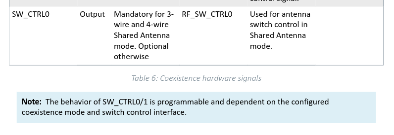

Reading the NRF7001's product specification I found this section stating that the behavior of SW_CTRL0/1 is programmable and dependent on the coexistence mode.

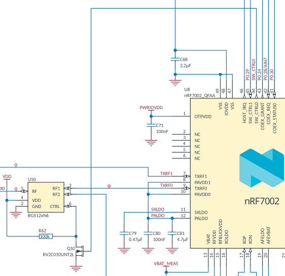

However, I could not find any information on how this works exactly. I just saw the schematics of the NRF7002DK and looked at the antenna switch (see below).

  • What is the default behavior of the SW_CTRL0 pin? In the image above it looks like the NRF7002 is setting SW_CTRL0 high whenever it wants to send.
  • Can this behavior be changed?
  • Is there any Nordic-specific setup of the coexistence interface I have to do in Zephyr?
