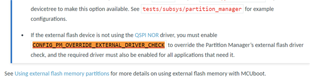

  • Yep, boots. So I'd say this is a bug, that one can work around with CONFIG_PM_OVERRIDE_EXTERNAL_DRIVER_CHECK=y.
    Make sure it is set to 'y' for both the application code and mcuboot. This is harder than it should be with sysbuild in between you and both these builds. Double-check it before testing.
    There's further investigation pending on why a partition on an external but very standard JEDEC flash is somehow considered a partition without suitable driver available (really CONFIG_SPI_FLASH is all you need, and I had it enabled all this time for both appcode & mcuboot) but one can work around it by setting the before mentioned PM_OVERRIDE_EXTERNAL_DRIVER_CHECK.
    Solved, I guess?
    On to the next thing that blows up. But this crime scene is solved, for now at least. As for the exact motives of the perpetrator, some further investigation is needed.
  • Hi Maarten,
    Thanks for the detailed investigation.
    I think you found the right culprit. I haven't looked deep into this but from what I can see in the doc:
    https://docs.nordicsemi.com/bundle/ncs-latest/page/nrf/scripts/partition_manager/partition_manager.html
    If it's not QSPI NOR then you will have to use CONFIG_PM_OVERRIDE_EXTERNAL_DRIVER_CHECK=y. In your case you are using SPI so need to override the PM driver ?
