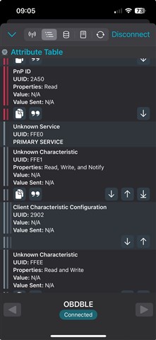

    I scanned for the device on the nrf connect app and this is what I got.
    The service I am interested in is the FFE0 and the characteristic used to read and write is FFE1
  • Strange. It looks like it uses a short UUID (16 bit), but it is not registered with Bluetooth:
    https://www.bluetooth.com/wp-content/uploads/Files/Specification/HTML/Assigned_Numbers/out/en/Assigned_Numbers.pdf?v=1726574177481
    (page 76)
    Perhaps it is possible to purchase a 16-bit UUID and not publish it's use. I don't remember.
    But yes, it looks like the service you are looking for is 0xFFE0, and the characteristics are 0xFFE1 and 0xFFEE. In this case, when it is a 16 bit UUID, I suggest you look into the ble_app_hrs_c example, as this uses a 16 bit UUID.
    I can't tell from your screenshot, but it looks like the 0xFFE1 is a characteristic on which you would want to enable notifications, and the 0xFFEE is probably one you would want to write to (the arrows in the app will tell you).
    However, on what format the OBDBLE device expects it's data, I don't know. You will have to check with the producer of this device.
    But your steps should be: Look at the ble_app_hrs_c example on how to do discovery on a 16 bit (short) UUID. Then you can look at the ble_app_uart_c example for how to enable notifications, and write to a characteristic. I suspect it is quite similar to the ble_app_uart/ble_app_uart_c application, apart from the 16-bit UUID.
    Edvin

  • So do I need to add the service UUID here?
    uint32_t ble_obd_c_init(ble_obd_c_t * p_ble_obd_c, ble_obd_c_init_t * p_ble_obd_c_init)
        uint32_t      err_code;
        ble_uuid_t    obd_uuid;
        ble_uuid128_t obd_base_uuid = OBD_BASE_UUID;
        VERIFY_PARAM_NOT_NULL(p_ble_obd_c);
        VERIFY_PARAM_NOT_NULL(p_ble_obd_c_init);
        VERIFY_PARAM_NOT_NULL(p_ble_obd_c_init->p_gatt_queue);
        err_code = sd_ble_uuid_vs_add(&obd_base_uuid, &p_ble_obd_c->uuid_type);
        VERIFY_SUCCESS(err_code);
        obd_uuid.type = p_ble_obd_c->uuid_type;
        obd_uuid.uuid = BLE_UUID_OBD_SERVICE;
        p_ble_obd_c->conn_handle           = BLE_CONN_HANDLE_INVALID;
        p_ble_obd_c->evt_handler           = p_ble_obd_c_init->evt_handler;
        p_ble_obd_c->error_handler         = p_ble_obd_c_init->error_handler;
        p_ble_obd_c->handles.obd_tx_handle = BLE_GATT_HANDLE_INVALID;
        p_ble_obd_c->handles.obd_rx_handle = BLE_GATT_HANDLE_INVALID;
        p_ble_obd_c->p_gatt_queue          = p_ble_obd_c_init->p_gatt_queue;
        return ble_db_discovery_evt_register(&obd_uuid);
    I have the base UUID, service UUID and characteristic defined as follows:
    #define BASE_UUID {0xFB, 0x34, 0x9B, 0x5F, 0x80, 0x00, 0x00, 0x80, 0x00, 0x10, 0x00, 0x00, 0x00, 0x00, 0x00, 0x00}
    #define BLE_UUID_OBD_SERVICE 0xFFE0                  /**< The UUID of the OBD Service. */
    #define BLE_UUID_OBD_CHARACTERISTIC 0xFFE1  /**< The UUID of the RX and TX Characteristic. */
  • yes, but it is not a vendor specific UUID (if it is only 16 bit long). So you can look at the ble_hrs_c_init() function for reference:
    uint32_t ble_hrs_c_init(ble_hrs_c_t * p_ble_hrs_c, ble_hrs_c_init_t * p_ble_hrs_c_init)
        VERIFY_PARAM_NOT_NULL(p_ble_hrs_c);
        VERIFY_PARAM_NOT_NULL(p_ble_hrs_c_init);
        ble_uuid_t hrs_uuid;
        hrs_uuid.type = BLE_UUID_TYPE_BLE;
        hrs_uuid.uuid = BLE_UUID_HEART_RATE_SERVICE;
        p_ble_hrs_c->evt_handler                 = p_ble_hrs_c_init->evt_handler;
        p_ble_hrs_c->error_handler               = p_ble_hrs_c_init->error_handler;
        p_ble_hrs_c->p_gatt_queue                = p_ble_hrs_c_init->p_gatt_queue;
        p_ble_hrs_c->conn_handle                 = BLE_CONN_HANDLE_INVALID;
        p_ble_hrs_c->peer_hrs_db.hrm_cccd_handle = BLE_GATT_HANDLE_INVALID;
        p_ble_hrs_c->peer_hrs_db.hrm_handle      = BLE_GATT_HANDLE_INVALID;
        return ble_db_discovery_evt_register(&hrs_uuid);
    As you can see, it is mostly the same, but you don't need the sd_ble_uuid_vs_add() (softdevice_bluetooth low energy_uuid_vendor specific_add())
    Vendor specific refers to 128-bit UUIDs, as the are specified by the vendor. 16 bit uuids are "standard" UUIDs. Look at the ble_app_hrs_c example for reference.
