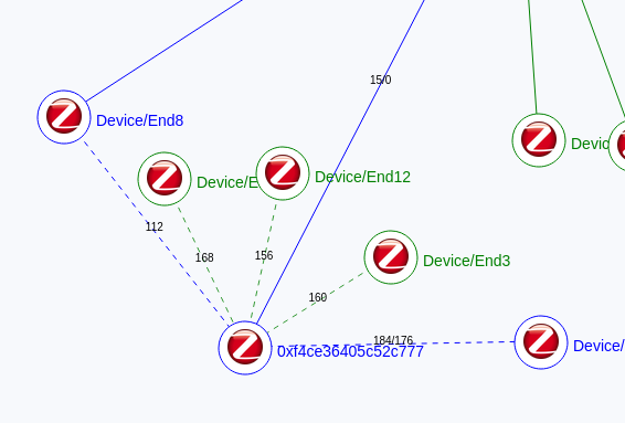

  • Hi Elfving,
    I’ve increased CONFIG_HEAP_MEM_POOL_SIZE and CONFIG_SYSTEM_WORKQUEUE_STACK_SIZE to 4096 and, as you said, it just postponed the problem.
    Furthermore the problem happens as soon as I increase the number of end-devices connected to that particular router.
    Now I will try to lower MEM_POLL and WQ_STACK_SIZE.
    0xf4ce36405c52c777 is the router.
    Logs:
    4934 4145 3934 4036 4078 3694 3978 5163   <- RMS values
    E: k_mem_slab_max_used_get: 3               <- I2S SLAB usage
    W: Parent is unreachable
    I: Unimplemented signal (signal: 50, status: 0)
    E: Failed to allocate next RX buffer: -12                        <- No more memory
    E: Failed to read data: -5 140
    E: k_mem_slab_max_used_get (failed): 4
    E: Failed to trigger (stop) i2s interface (fail): -5
    From no on, I2S interface is dead, but the ZB stack is still working.
