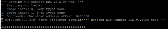

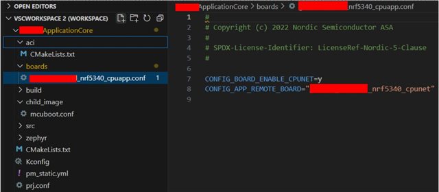

Mcuboot configuration is included in our main project (application core) as follows: project_folder/child_image/mcuboot.conf, and without any specification on the log method in such file, the application core shows mcuboot logs as expected :
But the network core does not show any log related to bootloader, but only the following:

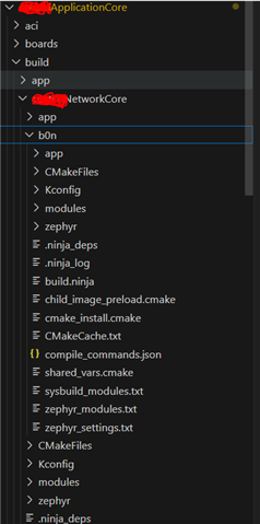

When the project is built, we can see that b0n seems to build OK in the network core child image build folder:

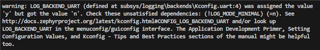

As an interesting detail, during the build, after === child image mcuboot -  begin ===, we receive the following warning:
but despite that warning, we do see the mcuboot logs correctly in the appplication core.

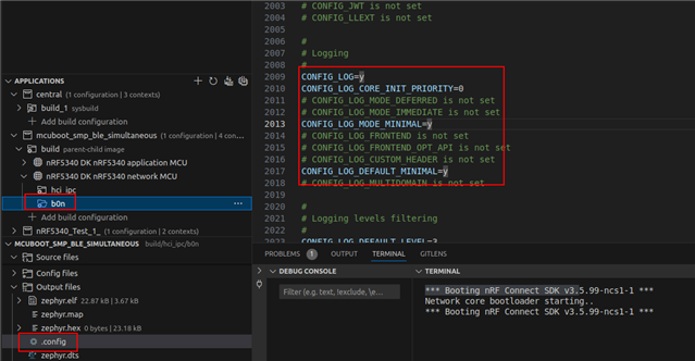

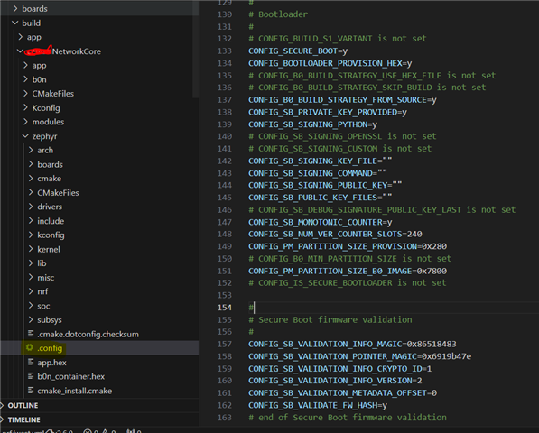

  • Just to add some info, in applicationCore/build/networkCore/zephyr/.config, b0n (b0 locally) seems to be corretly enabled:
    At the same time, we tried enabling RTT logging in network core instead of UART, and we see exactly the same loggins that we see in UART interface: firmware logs correctly but not bootloader - BTW, I read in other messages that this is the expected behaviour in RTT, so is just to add any extra info that can help to debug the issue more easily.

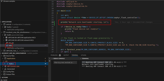

    The minimal logger and console output over UART should be enabled by default in the Network core bootloader (B0n). However, it will only print the boot banner (i.e. "*** Booting nRF Connect SDK v... ***") unless a runtime error occurs during boot.
    You can add this log message shown below in the bootloader main.c to test the console output:
    Vidar

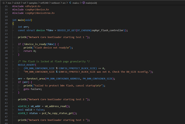

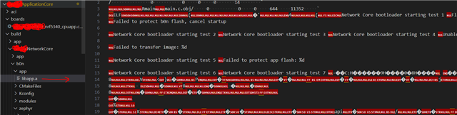

  • Hello Vidar, I added many printk() in C:\ncs\v2.6.0\nrf\samples\nrf5340\netboot\src\main.c
    then deleted the build configuration in my project and did a complete build, and looking at the corresponding libapp.a they were included in the build

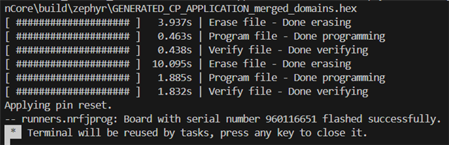

    But even after a succesfull flashing
    I can't see any difference in netCore logs

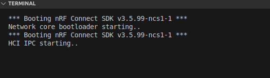

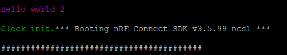

    The boot banner should be printed twice from the netcore during bootup, first when the netcore bootloader starts, and then when the 'hci_ipc' app starts.
    Here I added a printk with "HCI IPC starting.." in the hci_ipc image to illustrate:

    No, because your build folder content shows that b0n is included in the build.

    I am building for a custom board that has the nRF5340. I'm finally able to see the B0N exactly as you say, with the banner being printed twice, and the message in the middle

    1. How/where should I add an overlay or equivalent file in our project, to be able to add this configurations in B0N without modifying ncs folder at all?
    Our project structure is basically as follows (described also in first message):
    with separate folders for boards files, and also a separate folder for networkCore source and configuration files.
