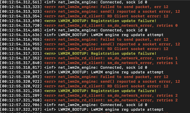

Using Lwm2m (DTLS PSK) and a custom service (COAPS [DTLS PSK]) at the same time
OS: nrf-sdk v2.6.1
Hardware: NRF52840 custom board
Network: OpenThread
Setup
Our device uses LwM2M [queue mode] (DTLS - PSK) for device control and monitoring remotely, using port 5684.
We are also developing a local interface using COAPS (DTLS - PSK) for controlling devices on the local network, using port 5688.
Both interfaces use the same network interface which is implemented using OpenThread.
Both interfaces work well when not used together; however we want both interfaces to be accessible at the same time.
Implementation
The LwM2M stack is provided by nrf-sdk / zephyr.
The "local interface" uses OpenThread's COAPS functions, which is effectively a copy paste of the CLI functions: (https://openthread.io/reference/cli/concepts/coaps).
Problem
When the device performs an LwM2M registration or update, it keeps the socket open for "CONFIG_LWM2M_QUEUE_MODE_UPTIME" seconds. During this time it is not possible to communicate with the device via the "local interface".
Once LwM2M closes its socket, the device can then be accessed via the local interface.
Question
Taking that both the LwM2M stack and our "local interface" stack use different ports. Why is it not possible to connect to the device when one already has an open connection?
Is it because the LwM2M stack and Openthread use the same MBEDTLS functions? If so, is there a way around this?
Cheers,
Sam

  • Hi Amanda,
    Any updates? Is there anything else i can provide to help?

  • More detailed logs from the nrf device when COAPS is open and LwM2M is trying to connect but failing.
    Now if i close the COAPS connection LwM2M will succeed.
    <wrn> LWM2M_BOOTUP: Registration update failure!
    [00:25:12.914,398] <err> net_lwm2m_rd_client: sm_do_network_error, retries 0
    [00:25:13.687,774] <dbg> net_pkt: pkt_alloc_with_buffer: (nrf5_rx): On iface 0x20001308 size 70
    [00:25:13.687,835] <dbg> net_pkt: net_pkt_alloc_buffer_debug: (nrf5_rx): Data allocation maximum size 70 (requested 70)
    [00:25:13.687,927] <dbg> net_pkt: pkt_alloc_buffer: (nrf5_rx): RDATA (?) [0] frag 0x20036494 ref 1 (nrf5_rx_thread():178)
    [00:25:13.687,957] <dbg> net_pkt: net_pkt_write: (nrf5_rx): pkt 0x2003731c data 0x200247f0 length 70
    [00:25:13.687,988] <dbg> net_core: net_recv_data: (nrf5_rx): prio 0 iface 0x20001308 pkt 0x2003731c len 70
    [00:25:13.688,262] <dbg> net_core: net_rx: (rx_q[0]): Received pkt 0x2003731c len 70
    [00:25:13.688,354] <dbg> net_core: processing_data: (rx_q[0]): Consumed pkt 0x2003731c
    [00:25:13.688,720] <dbg> net_pkt: pkt_alloc_with_buffer: (openthread): On iface 0x20001308 size 91
    [00:25:13.688,781] <dbg> net_pkt: net_pkt_alloc_buffer_debug: (openthread): Data allocation maximum size 91 (requested 91)
    [00:25:13.688,842] <dbg> net_pkt: pkt_alloc_buffer: (openthread): RDATA (?) [0] frag 0x20036408 ref 1 (ot_receive_handler():243)
    [00:25:13.688,903] <dbg> net_core: net_recv_data: (openthread): prio 0 iface 0x20001308 pkt 0x2003737c len 91
    [00:25:13.690,399] <dbg> net_pkt: net_pkt_unref_debug: (openthread): RX [8] pkt 0x2003731c ref 0 frags 0x20036494 (openthread_handle_received_frame():486)
    [00:25:13.690,490] <dbg> net_pkt: net_pkt_unref_debug: (openthread): RDATA (?) [0] frag 0x20036494 ref 0 frags (nil) (openthread_handle_received_frame():486)
    [00:25:13.690,551] <dbg> net_pkt: net_pkt_frag_unref_debug: (openthread): RDATA (?) [0] frag 0x20036494 ref 0 (net_pkt_unref_debug():597)
    [00:25:13.690,795] <dbg> net_core: net_rx: (rx_q[0]): Received pkt 0x2003737c len 91
    [00:25:13.690,979] <dbg> net_ipv6: net_ipv6_input: (rx_q[0]): IPv6 packet len 91 received from fe80::6c08:8584:618:655a to ff02::1
    [00:25:13.691,009] <dbg> net_pkt: net_pkt_skip: (rx_q[0]): pkt 0x2003737c skip 40
    [00:25:13.691,040] <dbg> net_pkt: net_pkt_write: (rx_q[0]): pkt 0x2003737c data 0x200365ac length 8
    [00:25:13.691,070] <dbg> net_pkt: net_pkt_skip: (rx_q[0]): pkt 0x2003737c skip 8
    [00:25:13.691,131] <dbg> net_pkt: net_pkt_skip: (rx_q[0]): pkt 0x2003737c skip 8
    [00:25:13.691,162] <dbg> net_pkt: net_pkt_skip: (rx_q[0]): pkt 0x2003737c skip 32
    [00:25:13.691,223] <dbg> net_conn: net_conn_input: (rx_q[0]): Check UDP listener for pkt 0x2003737c src port 19788 dst port 19788 family 2
    [00:25:13.691,253] <dbg> net_conn: net_conn_input: (rx_q[0]): No match found.
    [00:25:13.691,284] <dbg> net_core: processing_data: (rx_q[0]): Dropping pkt 0x2003737c
    [00:25:13.691,345] <dbg> net_pkt: net_pkt_unref_debug: (rx_q[0]): RX [9] pkt 0x2003737c ref 0 frags 0x20036408 (processing_data():174)
    [00:25:13.691,406] <dbg> net_pkt: net_pkt_unref_debug: (rx_q[0]): RDATA (?) [0] frag 0x20036408 ref 0 frags (nil) (processing_data():174)
    [00:25:13.691,497] <dbg> net_pkt: net_pkt_frag_unref_debug: (rx_q[0]): RDATA (?) [0] frag 0x20036408 ref 0 (net_pkt_unref_debug():597)
    [00:25:20.914,459] <err> net_lwm2m_rd_client: sm_do_network_error, retries 0
    [00:25:20.914,611] <inf> net_lwm2m_rd_client: RD Client started with endpoint '5678-ABCD' with client lifetime 432000 using server object 0
    [00:25:20.915,069] <dbg> net_sock_tls: tls_alloc: (lwm2m-sock-recv): Allocated TLS context, 0x20006488
    [00:25:20.915,405] <dbg> net_sock: zsock_socket_internal: (lwm2m-sock-recv): socket: ctx=0x200199a4, fd=1
    [00:25:20.915,710] <dbg> net_ctx: net_context_bind: (lwm2m-sock-recv): Context 0x200199a4 binding to UDP [::]:41472 iface 1 (0x20001308)
    [00:25:20.915,893] <dbg> net_conn: conn_register_debug: (lwm2m-sock-recv): [0x20019c50/17/2/0x3f] remote fd73:7cbd:c88a:2::1010:b15a/5684
    [00:25:20.915,924] <dbg> net_conn: conn_register_debug: (lwm2m-sock-recv):   local ::/41472 cb 0x44f2d ud (nil)
    [00:25:20.915,985] <inf> net_lwm2m_engine: Connected, sock id 0
    [00:25:20.917,694] <dbg> net_sock_tls: tls_mbedtls_init: (lwm2m-sock-recv): Using user-specified ciphersuites
    [00:25:20.917,816] <err> net_lwm2m_engine: Failed to send packet, err 12
    [00:25:20.917,816] <err> net_lwm2m_engine: send() reported a socket error, 12
    [00:25:20.917,846] <err> net_lwm2m_rd_client: RD Client socket error: 12
    [00:25:20.917,877] <dbg> net_sock: z_impl_zsock_close: (lwm2m-sock-recv): close: ctx=0x20006488, fd=0
    [00:25:20.918,090] <dbg> net_sock: z_impl_zsock_close: (lwm2m-sock-recv): close: ctx=0x200199a4, fd=1
    [00:25:20.918,121] <dbg> net_conn: net_conn_unregister: (lwm2m-sock-recv): Connection handler 0x20019c50 removed
    [00:25:20.918,304] <dbg> net_conn: conn_register_debug: (lwm2m-sock-recv): [0x20019c50/17/2/0x3f] remote fd73:7cbd:c88a:2::1010:b15a/5684
    [00:25:20.918,365] <dbg> net_conn: conn_register_debug: (lwm2m-sock-recv):   local ::/41472 cb 0x44f2d ud (nil)
    [00:25:20.918,395] <dbg> net_conn: net_conn_unregister: (lwm2m-sock-recv): Connection handler 0x20019c50 removed
    [00:25:20.918,457] <dbg> net_ctx: net_context_unref: (lwm2m-sock-recv): Context 0x200199a4 released
    [00:25:20.918,487] <wrn> LWM2M_BOOTUP: Registration update failure!
    [00:25:20.918,518] <err> net_lwm2m_rd_client: sm_do_network_error, retries 1
    [00:25:21.918,914] <err> net_lwm2m_rd_client: sm_do_network_error, retries 1
    [00:25:21.919,067] <inf> net_lwm2m_rd_client: RD Client started with endpoint '5678-ABCD' with client lifetime 432000 using server object 0
    [00:25:21.919,555] <dbg> net_sock_tls: tls_alloc: (lwm2m-sock-recv): Allocated TLS context, 0x20006488
    [00:25:21.919,891] <dbg> net_sock: zsock_socket_internal: (lwm2m-sock-recv): socket: ctx=0x200199a4, fd=1
    [00:25:21.920,196] <dbg> net_ctx: net_context_bind: (lwm2m-sock-recv): Context 0x200199a4 binding to UDP [::]:60888 iface 1 (0x20001308)
    [00:25:21.920,379] <dbg> net_conn: conn_register_debug: (lwm2m-sock-recv): [0x20019c50/17/2/0x3f] remote fd73:7cbd:c88a:2::1010:b15a/5684
    [00:25:21.920,410] <dbg> net_conn: conn_register_debug: (lwm2m-sock-recv):   local ::/60888 cb 0x44f2d ud (nil)
    [00:25:21.920,471] <inf> net_lwm2m_engine: Connected, sock id 0
    [00:25:21.922,180] <dbg> net_sock_tls: tls_mbedtls_init: (lwm2m-sock-recv): Using user-specified ciphersuites
    [00:25:21.922,302] <err> net_lwm2m_engine: Failed to send packet, err 12
    [00:25:21.922,332] <err> net_lwm2m_engine: send() reported a socket error, 12
    [00:25:21.922,332] <err> net_lwm2m_rd_client: RD Client socket error: 12
    [00:25:21.922,363] <dbg> net_sock: z_impl_zsock_close: (lwm2m-sock-recv): close: ctx=0x20006488, fd=0
    [00:25:21.922,607] <dbg> net_sock: z_impl_zsock_close: (lwm2m-sock-recv): close: ctx=0x200199a4, fd=1
    [00:25:21.922,637] <dbg> net_conn: net_conn_unregister: (lwm2m-sock-recv): Connection handler 0x20019c50 removed
    [00:25:21.922,821] <dbg> net_conn: conn_register_debug: (lwm2m-sock-recv): [0x20019c50/17/2/0x3f] remote fd73:7cbd:c88a:2::1010:b15a/5684
    [00:25:21.922,851] <dbg> net_conn: conn_register_debug: (lwm2m-sock-recv):   local ::/60888 cb 0x44f2d ud (nil)
    [00:25:21.922,882] <dbg> net_conn: net_conn_unregister: (lwm2m-sock-recv): Connection handler 0x20019c50 removed
    [00:25:21.922,943] <dbg> net_ctx: net_context_unref: (lwm2m-sock-recv): Context 0x200199a4 released
    [00:25:21.922,973] <wrn> LWM2M_BOOTUP: Registration update failure!
    [00:25:21.923,004] <err> net_lwm2m_rd_client: sm_do_network_error, retries 2
    [00:25:23.271,240] <dbg> net_pkt: pkt_alloc_with_buffer: (openthread): On iface 0x20001308 size 91
    [00:25:23.271,270] <dbg> net_pkt: net_pkt_alloc_buffer_debug: (openthread): Data allocation maximum size 91 (requested 91)
    [00:25:23.271,362] <dbg> net_pkt: pkt_alloc_buffer: (openthread): RDATA (?) [0] frag 0x20036408 ref 1 (ot_receive_handler():243)
    [00:25:23.271,423] <dbg> net_core: net_recv_data: (openthread): prio 0 iface 0x20001308 pkt 0x2003737c len 91
    [00:25:23.272,125] <dbg> net_core: net_rx: (rx_q[0]): Received pkt 0x2003737c len 91
    [00:25:23.272,308] <dbg> net_ipv6: net_ipv6_input: (rx_q[0]): IPv6 packet len 91 received from fe80::28ea:4ef:3875:6f6 to ff02::1
    [00:25:23.272,338] <dbg> net_pkt: net_pkt_skip: (rx_q[0]): pkt 0x2003737c skip 40
    [00:25:23.272,369] <dbg> net_pkt: net_pkt_write: (rx_q[0]): pkt 0x2003737c data 0x200365ac length 8
    [00:25:23.272,430] <dbg> net_pkt: net_pkt_skip: (rx_q[0]): pkt 0x2003737c skip 8
    [00:25:23.272,460] <dbg> net_pkt: net_pkt_skip: (rx_q[0]): pkt 0x2003737c skip 8
    [00:25:23.272,491] <dbg> net_pkt: net_pkt_skip: (rx_q[0]): pkt 0x2003737c skip 32
    [00:25:23.272,552] <dbg> net_conn: net_conn_input: (rx_q[0]): Dropping invalid src/dst end-points packet
    [00:25:23.272,583] <dbg> net_core: processing_data: (rx_q[0]): Dropping pkt 0x2003737c
    [00:25:23.272,644] <dbg> net_pkt: net_pkt_unref_debug: (rx_q[0]): RX [9] pkt 0x2003737c ref 0 frags 0x20036408 (processing_data():174)
    [00:25:23.272,705] <dbg> net_pkt: net_pkt_unref_debug: (rx_q[0]): RDATA (?) [0] frag 0x20036408 ref 0 frags (nil) (processing_data():174)
    [00:25:23.272,796] <dbg> net_pkt: net_pkt_frag_unref_debug: (rx_q[0]): RDATA (?) [0] frag 0x20036408 ref 0 (net_pkt_unref_debug():597)
    [00:25:23.923,980] <err> net_lwm2m_rd_client: sm_do_network_error, retries 2
    [00:25:23.925,842] <inf> net_lwm2m_rd_client: RD Client started with endpoint '5678-ABCD' with client lifetime 432000 using server object 0
    [00:25:23.926,300] <dbg> net_sock_tls: tls_alloc: (lwm2m-sock-recv): Allocated TLS context, 0x20006488
    [00:25:23.926,666] <dbg> net_sock: zsock_socket_internal: (lwm2m-sock-recv): socket: ctx=0x200199a4, fd=1
    [00:25:23.927,001] <dbg> net_ctx: net_context_bind: (lwm2m-sock-recv): Context 0x200199a4 binding to UDP [::]:61982 iface 1 (0x20001308)
    [00:25:23.927,154] <dbg> net_conn: conn_register_debug: (lwm2m-sock-recv): [0x20019c50/17/2/0x3f] remote fd73:7cbd:c88a:2::1010:b15a/5684
    [00:25:23.927,215] <dbg> net_conn: conn_register_debug: (lwm2m-sock-recv):   local ::/61982 cb 0x44f2d ud (nil)
    [00:25:23.927,246] <inf> net_lwm2m_engine: Connected, sock id 0
    [00:25:23.928,985] <dbg> net_sock_tls: tls_mbedtls_init: (lwm2m-sock-recv): Using user-specified ciphersuites
    [00:25:23.929,107] <err> net_lwm2m_engine: Failed to send packet, err 12
    [00:25:23.929,107] <err> net_lwm2m_engine: send() reported a socket error, 12
    [00:25:23.929,138] <err> net_lwm2m_rd_client: RD Client socket error: 12
    [00:25:23.929,168] <dbg> net_sock: z_impl_zsock_close: (lwm2m-sock-recv): close: ctx=0x20006488, fd=0
    [00:25:23.929,382] <dbg> net_sock: z_impl_zsock_close: (lwm2m-sock-recv): close: ctx=0x200199a4, fd=1
    [00:25:23.929,443] <dbg> net_conn: net_conn_unregister: (lwm2m-sock-recv): Connection handler 0x20019c50 removed
    [00:25:23.929,595] <dbg> net_conn: conn_register_debug: (lwm2m-sock-recv): [0x20019c50/17/2/0x3f] remote fd73:7cbd:c88a:2::1010:b15a/5684
    [00:25:23.929,656] <dbg> net_conn: conn_register_debug: (lwm2m-sock-recv):   local ::/61982 cb 0x44f2d ud (nil)
    [00:25:23.929,687] <dbg> net_conn: net_conn_unregister: (lwm2m-sock-recv): Connection handler 0x20019c50 removed
    [00:25:23.929,748] <dbg> net_ctx: net_context_unref: (lwm2m-sock-recv): Context 0x200199a4 released
    [00:25:23.929,779] <wrn> LWM2M_BOOTUP: Registration update failure!
    [00:25:23.929,809] <err> net_lwm2m_rd_client: sm_do_network_error, retries 3

    [00:25:27.929,870] <err> net_lwm2m_rd_client: sm_do_network_error, retries 3
    [00:25:27.929,901] <err> net_lwm2m_rd_client: Network error, max retries reached (4)
    [00:25:27.929,901] <err> net_lwm2m_obj_server: No server candidate found
    [00:25:27.929,901] <wrn> LWM2M_BOOTUP: LwM2M engine reported a network error.
  • After more debugging i managed to chase the issue down to zephyr/subsys/net/lib/sockets/sockets_tls.c line 1398.
    Where the call to mbedtls_ssl_setup is returning 32512 / 0x7F00. This is apparently a memory allocation issue.
    We have the following set for MBED which seems relevant; any suggestions?
    CONFIG_MBEDTLS_ENABLE_HEAP=y
    CONFIG_MBEDTLS_HEAP_SIZE=8192
    CONFIG_MBEDTLS_SSL_MAX_CONTENT_LEN=1500
    Debug images
  • Check out this post and try to increase the value of CONFIG_MBEDTLS_SSL_MAX_CONTENT_LEN.
    Sorry slow on this, we decided to do this within a wider update of MBEDTLS setup.
    It looks like the problem might have been fixed by change the stack values. Once we confirm it's fixed we'll post  what we changed.
    Cheers,
    Sam
