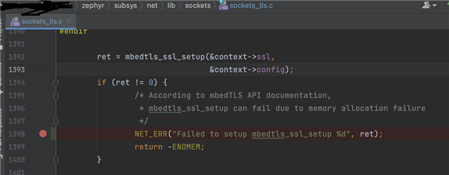

Problem
When the device performs an LwM2M registration or update, it keeps the socket open for "CONFIG_LWM2M_QUEUE_MODE_UPTIME" seconds. During this time it is not possible to communicate with the device via the "local interface".
Once LwM2M closes its socket, the device can then be accessed via the local interface.
Question
Taking that both the LwM2M stack and our "local interface" stack use different ports. Why is it not possible to connect to the device when one already has an open connection?
Is it because the LwM2M stack and Openthread use the same MBEDTLS functions? If so, is there a way around this?

  • More detailed logs from the nrf device when COAPS is open and LwM2M is trying to connect but failing.
    Now if i close the COAPS connection LwM2M will succeed.

    [00:25:20.917,816] <err> net_lwm2m_engine: Failed to send packet, err 12
    [00:25:20.917,816] <err> net_lwm2m_engine: send() reported a socket error, 12
    [00:25:20.917,846] <err> net_lwm2m_rd_client: RD Client socket error: 12

  • After more debugging i managed to chase the issue down to zephyr/subsys/net/lib/sockets/sockets_tls.c line 1398.
    Where the call to mbedtls_ssl_setup is returning 32512 / 0x7F00. This is apparently a memory allocation issue.
    We have the following set for MBED which seems relevant; any suggestions?
    CONFIG_MBEDTLS_ENABLE_HEAP=y
    CONFIG_MBEDTLS_HEAP_SIZE=8192
    CONFIG_MBEDTLS_SSL_MAX_CONTENT_LEN=1500
    Debug images
  • Check out this post and try to increase the value of CONFIG_MBEDTLS_SSL_MAX_CONTENT_LEN.
    Sorry slow on this, we decided to do this within a wider update of MBEDTLS setup.
    It looks like the problem might have been fixed by change the stack values. Once we confirm it's fixed we'll post  what we changed.
