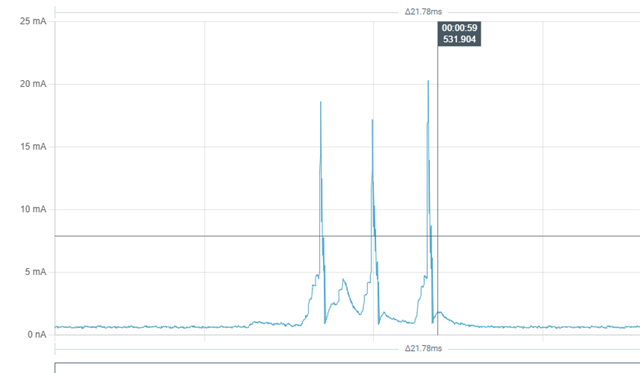

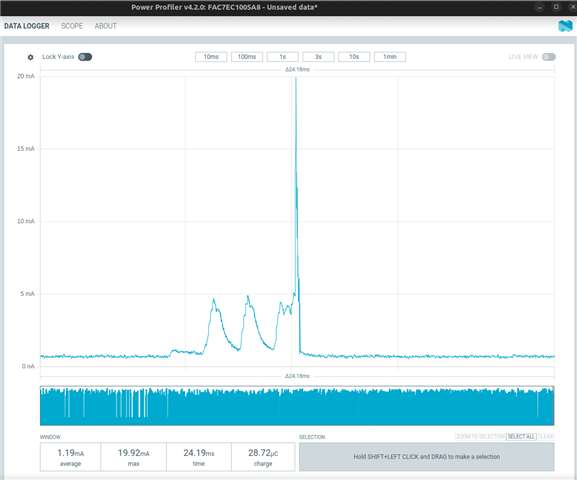

We observed that the RSSIs are poorer when we use the SoftDevice controller and compare it to the Zephyr controller. This was observed using the nRFConnect App on Android/iOS.
There is about a 20db difference between Zephyr and Nordic SoftDevice Controllers.
Here are the power profiler images for both.
1) SoftDevice Controller
2) Zephyr Controller
As we can see, the current spikes on the zephyr controller seem more consistent with peak currents compared to Nordic SoftDevice.
We also observed that a comment on the MPSL KConfig says that the
"# MPSL_FEM_GENERIC_TWO_CTRL_PINS is not supported on nRF53 yet"
https://github.com/nrfconnect/sdk-nrf/blob/v2.7.0/subsys/mpsl/fem/Kconfig#L59
We wanted to know if we're seeing the lower RSSI measured from the SoftDevice controller due to a compatibility issue.
I saw that even nRF54 supports this fully and only the nRF53 does not?
