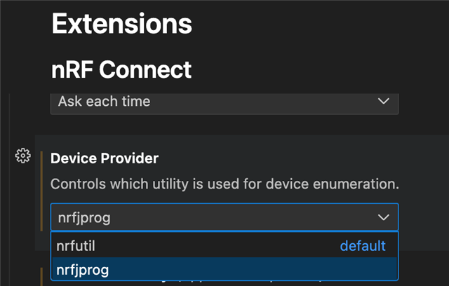

    With the latest "nRF Connect for VS Code" extension v2024.9.87, it looks like I have a workaround if I use nrfprog instead of nrfutil as the device enumerator in the nRF Connect extension settings.
    nrfjprog finds the J-Link Edu Mini under "CONNECTED DEVICES".

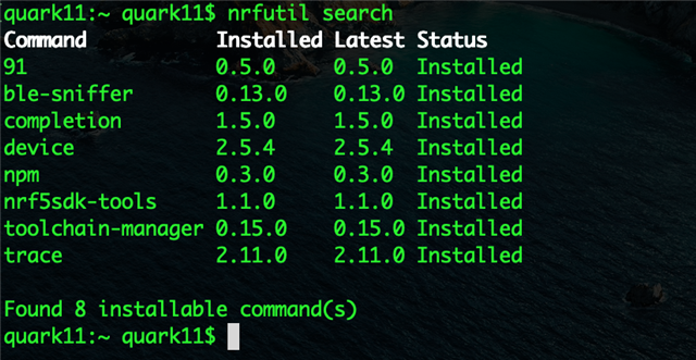

    I tried again to upgrade to the latest nrfutil b.y using the following
    1. $nrfutil self-upgrade
    2. $nrfutil upgrade
    Successfully upgraded nrfutil device command to 2.5.4 on macOS 11.x.
    Afterwards, switching the device enumerator back to nrfutil the J-Link probe still didn't appear under "CONNECTED DEVICES".

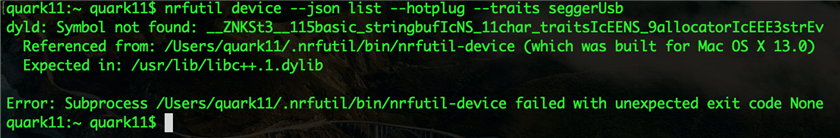

    I get the following error:
    Under macOS 12 (Monterey), the command nrfutil device --json list --hotplug --traits seggerUsb (although built for macOS 13) works.
    For now, I'll use nrfjprog as the device enumerator until I hear back from you.

    The error, from my earlier response, in running nrfutil device --json list --hotplug --traits seggerUsb seems to be because nrfutil Is now being built with macOS 13. However, this command runs fine under macOS 12 and J-Link device gets enumerated correctly.
    Can you please check if it is possible for dev to build nrfutil for macOS 11? J-Link device enumeration works with nrfjprog but not with nrfutil as the device provider in nrf-connect settings. Thank you.

    Unfortunately I don't think there is anything we are able to do at the moment for this because we are slowly moving support to the MacOS13 and in newer version of the SDK this will be the oldest supported version of the OS and hence currently you are building well with the macOS12 but not 11.
