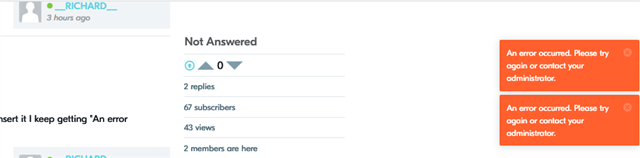

  • I'm trying to upload a file with the full output of a pristine build but when I try to insert it I keep getting "An error occurred".
  • I also can't just paste the build output directly in here. Frustrating.
  • Should also have said, I'm using NCS v2.6.1, and I haven't altered the sample source code at all. I've just created a build configuration and custom board files,
  • This ^ has happened about 25 times in the process of trying to upload a text file or send replies, even relatively short one. I'm just trying to get some build output into a message but I'm giving up now. This message board is almost as frustrating to use as the SDK.
