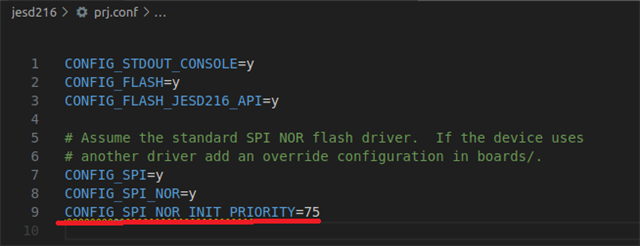

Hi Noridic team,
I am developing with nRF5340, and I added the following configuration to the prj file:
CONFIG_SPI_NOR_INIT_PRIORITY=75
However, I got the following error.
error: SPI_NOR_INIT_PRIORITY (defined at drivers/flash/Kconfig.nor:44) is assigned in a
configuration file, but is not directly user-configurable (has no prompt). It gets its value
indirectly from other symbols. See
http://docs.zephyrproject.org/latest/kconfig.html#CONFIG_SPI_NOR_INIT_PRIORITY and/or look up
SPI_NOR_INIT_PRIORITY in the menuconfig/guiconfig interface. The Application Development Primer,
Setting Configuration Values, and Kconfig - Tips and Best Practices sections of the manual might be
helpful too.
We need to update this because our product needs to access external memory with high priority.
How can I solve thi problem?

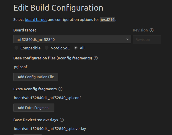

  • Hi dejans,
    I found a good example for our communication.
    I replaced the board with nrf52840dk_nrf52840 and used the example in zephyr/samples/drivers/jesd216. NCS SDK version is v2.6.0.
    Finally I updated the build configuration for spi nor flash.
    Boad target: nrf52840dk_nrf52840
    Base configuration files: prj.conf
    Extra Kconfig fragments: boards/nrf52840dk_nrf52840_spi.conf
    Base devicetree overlays: boards/nrf52840dk_nrf52840_spi.overlay

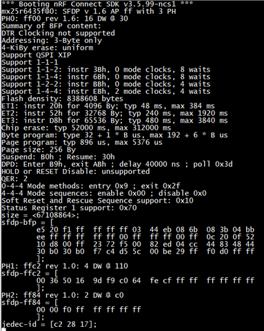

    Then I downloaded the firmware to the device after build. the device works fine.

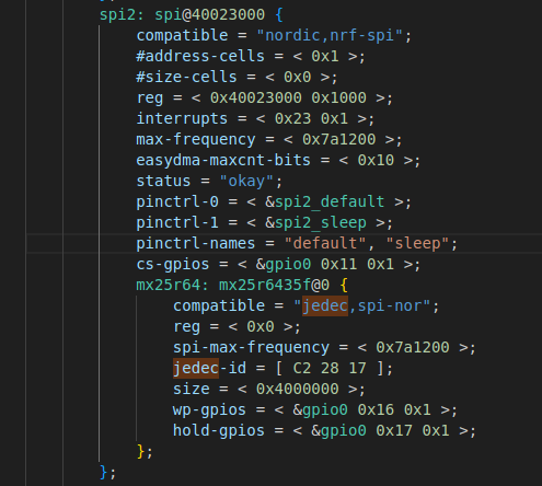

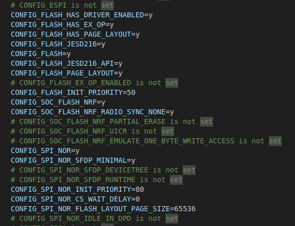

    I checked the .config file and the zephyr.dts file. And I couldn't find any errors.

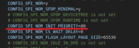

    The default value for CONFIG_SPI_NOR_INIT_PRIORITY is 80 as shown in the figure below. In this situation, what I want is to change the value of CONFIG_SPI_NOR_INIT_PRIORITY.
    I assigned CONFIG_SPI_NOR_INIT_PRIORITY=75 to the prj.conf file.
    Then I got the following error.
