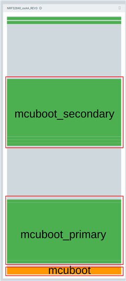

  • Hi Einar Thorsrud,
    thanks for your answer
    the flash map below is reading after BLE FOTA
    Are the partitions' names what I wrote correct?
    if so, can I generate new app_update.bin, and use jlink or something to programming bin file to mcuboot_secondary, and then swap to mcuboot_primary ?
    for example:
    mcuboot_secondary:
      address: 0x85000
      end_address: 0xfe000
    I programming new bin file to 0x85000 then I want mcuboot update this to app slot
    This looks good. I take it DFU works via BLE now?
    In principl yes, but it is not enough to just write the firmware image. There is also other metadata that is written together with the image normally via the SMP protocol. So you would have to write this in the image trailer as well via the debugger before you reset if you want to test like this.
