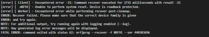

The environment setup I'm using is VsCode with the NRF extension. I'm using SDK v2.6.1. When flashing bootloader firmware to my device I get this output on my vs code terminal.
It looks like the readback protection of the NRF9151 is preventing me from flashing anything new to the device. Initially, when I tried flasing firmware, I got this popupFlashing failed due to protection on the device - Nordic Q&A - Nordic  DevZone - Nordic DevZone
When selecting yes it would run a nrfjprog --recover command which would do the trick, but after a while it stopped working. When manually running nrfjprog --recover I get the same error output in the first attachment.
I've tried running nrfjprog --eraseall as well and I get this on output

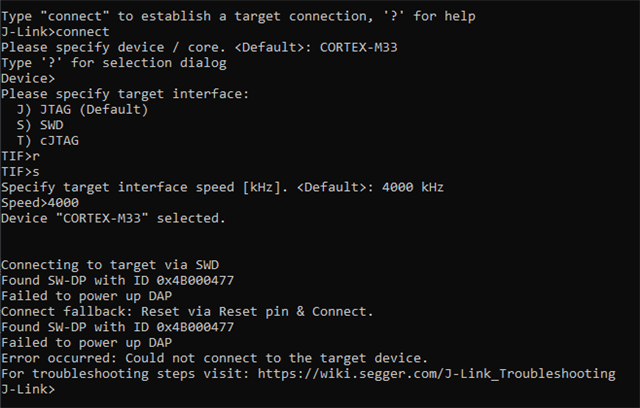

I've also tried to use JLink commander to manually write to the hardware registers but I can't connect to the device because the DAP won't power up.
I saw some other posts about the APProtect handling being broken but I'm not sure if it's the same issue. It could definitely be a hardware issue, but my gut is telling me that I accidently wrote something to the hardware registers that enabled erase protection as well, and now I'm locked out of the device completely. Here is the log file after running nrfjprog --recover -log
