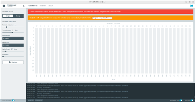

But it is not possible. Trying to select the FTDI based UART and running clicking "Start test" I see the following error:
At the same time I am connected to the board via RTT to view logs and don't see any communication.

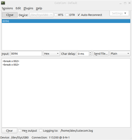

On the contrast when I use cutecom to send commands as hex codes directly, everything works as expected:

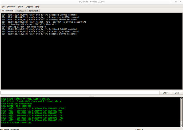

And I see the expected communication activity on the RTT logs:

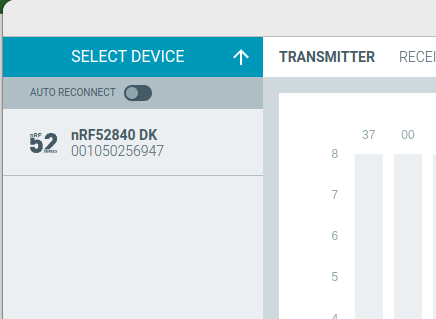

There are no problems by the way using a nrf52840DK. It only does not work with the custom board, connected via UART, although you explicitly write:
> The application also supports third-party devices that are programmed with the DTM standard protocol and expose access to it through a serial port.
