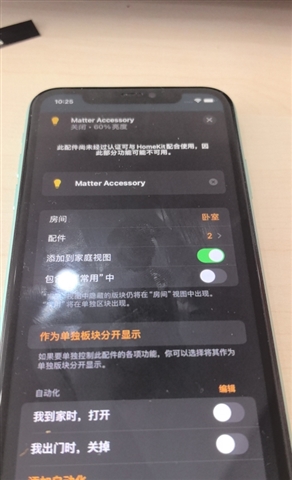

some cluster cannot work in homepod
Hello,i test sample light_bulb and add some cluster from zap,but only brightness adjustment can be use in iPhone home app.Color temperature function cannot found in app.And I try to add nrf52840 as matter device in Home Assistant,but the addition was not successful . Later I will provid screenshot to show what i meet.

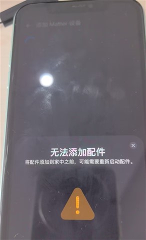

  • Homeassitant can't add device
    It say :Unable to add accessories.Before adding accessories to your home, you may need to restart them.But restart can't  solve the problem.
    I add a Matter Color Temperature Light (0x010C)  in zap.But it only can work as light bulb in homepod
    It say :This accessory has not been certified for use with HomeKit, so some functions may not be available.
    Did I miss any work that hasn't been completed yet?
    toolchain version:2.6.0
    sdk version: 2.6.0
    ios version:17.6.1
    ios type:iphone 11
    This video is about how I added a light switch to the home app and how the home app displays this device
  • I added a new cluster after completing the configuration method mentioned in the document, but the related functions of this cluster did not appear on the home app
