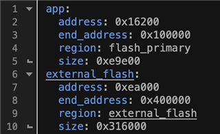

I'm updating an existing NCS 2.6 application (smp_ble_feat) for a Particle Xenon (nRF52840 board) that uses onboard 4MB SPI flash.
I've successfully built the new sysbuild version under NCS 2.7.0. In examining the partitions.yml file, I find that although the firmware uses 4Mb SPI flash for the app, mcuboot_secondary partition isn't using part of the 4MB SPI flash. It still uses the SOC flash.

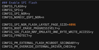

Here is the MCUBoot configuration, particle_xenon.conf:
# Disable Zephyr console
CONFIG_CONSOLE=n
# Multithreading
CONFIG_MULTITHREADING=y
# MCUBoot settings
CONFIG_BOOT_MAX_IMG_SECTORS=2048
# MCUboot serial recovery
CONFIG_MCUBOOT_SERIAL=y
CONFIG_BOOT_SERIAL_DETECT_DELAY=450
CONFIG_MCUBOOT_INDICATION_LED=y
CONFIG_BOOT_SERIAL_CDC_ACM=y
# USB
CONFIG_USB_DEVICE_STACK=y
CONFIG_USB_DEVICE_REMOTE_WAKEUP=n
CONFIG_USB_DEVICE_PRODUCT="XENON MCUBOOT"
CONFIG_PM_PARTITION_SIZE_MCUBOOT=0x16000
### Enable SPI flash
CONFIG_FLASH=y
CONFIG_SPI=y
CONFIG_SPI_NOR=y
CONFIG_NORDIC_QSPI_NOR=n
CONFIG_SPI_NOR_FLASH_LAYOUT_PAGE_SIZE=4096
CONFIG_BOOT_ERASE_PROGRESSIVELY=y
CONFIG_SOC_FLASH_NRF_EMULATE_ONE_BYTE_WRITE_ACCESS=y
CONFIG_FPROTECT=y
CONFIG_PM_EXTERNAL_FLASH_MCUBOOT_SECONDARY=y
CONFIG_PM_OVERRIDE_EXTERNAL_DRIVER_CHECK=y
### Enable serial recovery
CONFIG_BOOT_SERIAL_NO_APPLICATION=y
CONFIG_UART_CONSOLE=n

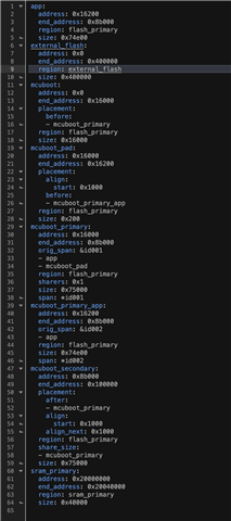

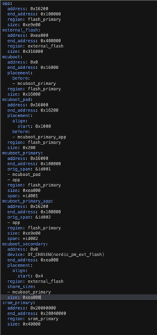

The generated partitions.yml from the NCS 2.7.0 sysbuild is shown below.
The app  sees the 4MB SPI flash corrrectly but none is being allocated to MCUBoot. The internal nRF52840 flash is still being used by mcuboot_secondary.
 partiton.

What am I doing incorrectly in updating from NCS 2.6 to NCS 2.7.0 sysbuild? The build appears to run fine but for some reason mcuboot_secondary still uses SOC Flash.

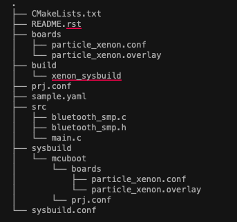

    Project structure is:

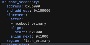

    With this setup, firmware built and ran successful. The app correctly used spi flash but mcuboot_secondary ended up using the soc flash.

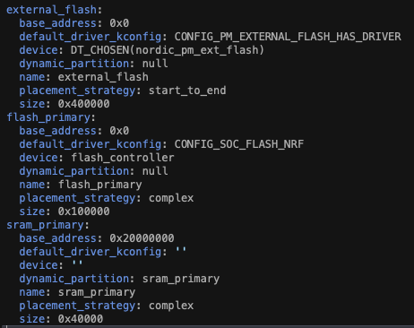

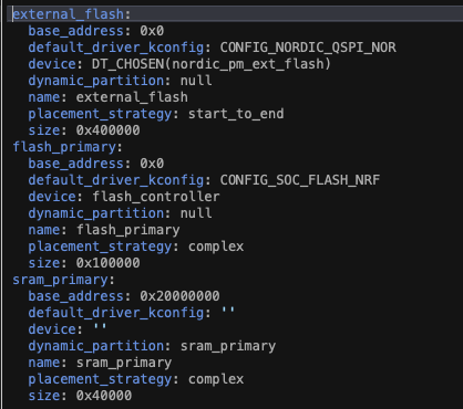

    regions.yml below shows that QSPI NOR flash has been selected despite setting in mcuboot/boot/zephyr/boards/particle_xenon.conf.

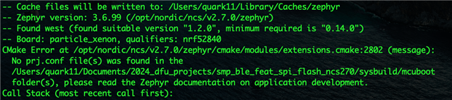

    Following your suggestion, I tried placing
    particle_xenon.conf in  smp_ble_feat_spi_flash_ncs270/sysbuild/mcuboot  and
    particle_xenon.overlay in  smp_ble_feat_spi_flash_ncs270/sysbuild/mcuboot/boards. However, the build failed with the following error.
    After renaming  particle_xenon.conf to prj.conf, build was successful but the mcuboot_secondary still isn't using the external flash. In fact, the firmware just goes into the MCUboot bootloader.
    Here is the revised project structure.
