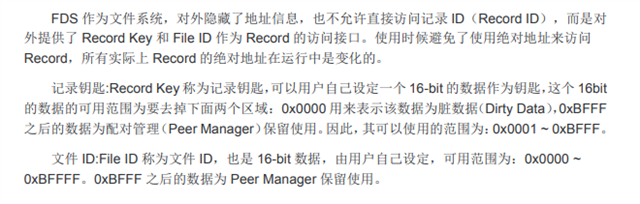

  • Maybe you ignored the picture in previous reply.
    It said the record key and file id was be saved for peer_manage start with 0xC0000.But the end value was not be refer to.And I want to know if their end value depends on pages.
    And maybe I'm wrong to understand the relationship of (record key and file id) with flash.If they are not related?
    About the question of FDS pages max value above.I think this situation exists that pages multiply by size more than 512KB that is the all flash size of nRF52832-QFAA.How it will deal it?
    Yes, I was unable to read that.
    The recod key and file ID is not related to where it is located on flash. The location will move around every time FDS garbage collection is perfomed. If you want to understand more about this you can see the FDS documentation.
