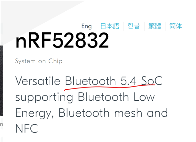

Hi
We want to use Bluetooth 5.4 protocol based on 52832.
Which version of softdevice does Bluetooth 5.4 require?
The protocol stack in use is as follows
S132_nrf52_7. 2.0 _softdevice. Hex
Tanks

Can S132 support Bluetooth 5.4 transmission?
It is unfortunately only BLE 5.1 qualified as of today.
-Priyanka
Hi Priyanka:
We want to use Bluetooth 5.4 on 52832.
How to use it?
If there are features in 5.2,5.3, 5.4 ,etc. that you are interested in, then these features might be implemented in NCS and the SoftDevice Controller.
-Priyanka
Thanks for your clarification. In theory, does NRF52832 whether support Bluetooth 5.4 or not?
Yes,
-Priyanka
Yes,
-Priyanka
