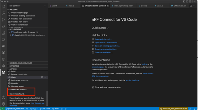

I have installed the Jlink driver and nRF sdk for 9160 on my macbook.
I use the nRF Connect for VS code to program, but I can't see the device under the connected devices.
Can you give me some guidance?

What USB cable are you using? Have you ensured that you are connecting a cable that supports both charging and data?
What is the board nRF91t60 MINICUBE? Is this a custom hardware?

Hi Øyvind
Thanks for your quick response.
The cable and board had been used and connected with windows operation without any problem.
Yes, I have connected the dockstation with the cable that supports both charging and data.
Now I try to use the exactly same board and cable to connect with macbook, it can't find the device.

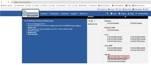

I believe that I download the right jlink driver. Or should I try Universal Instaler?
I
thanks for pointing out what OS you are on. Can you please install the MacOS Universal installer to test. Does the minicube have an onboard debugger or are you using an external debugger?

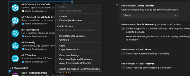

Hi Øyvind
I use macbook pro M2 and I have installed MacOS Universal installer which could connect the device with "Serial termial 1.4.1" but not with VS Code.
Please try to change the Device Provider in VS Code, which you can find under extension settings
I'm currently using nrfjprog
Øyvind
Thanks Øyvind, it works now.
