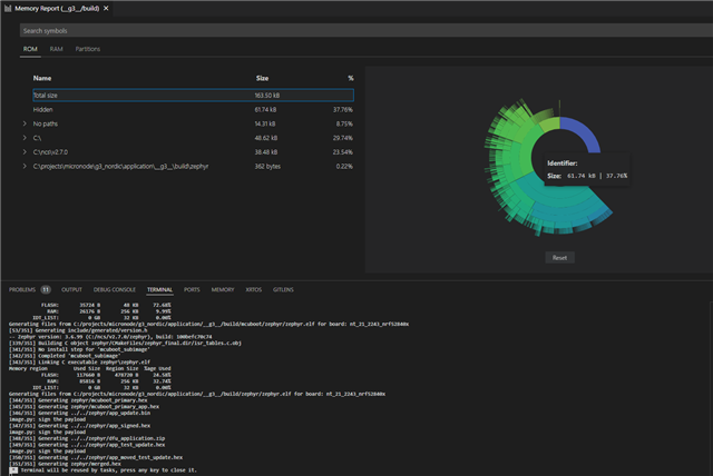

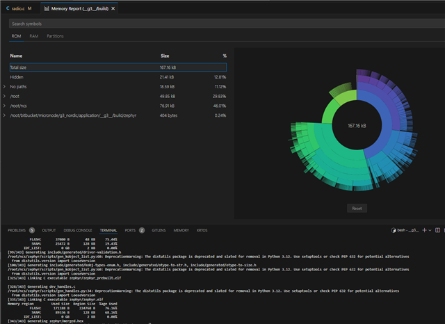

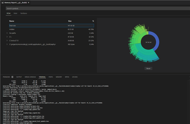

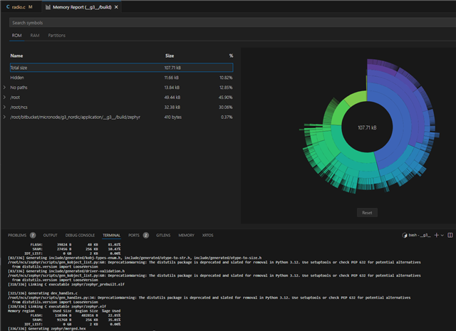

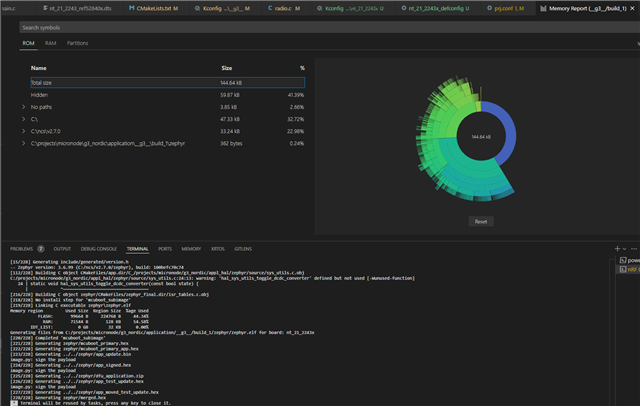

We are currently migrating our project, originally developed with NCS version 1.8.0, to the latest NCS 2.7.0, while incorporating MCUboot for both of them. During this process, I encountered an unusual issue related to memory size after compilation on the NRF52840 and NRF52833 MCUs, both with and without AES ECB encryption enabled for our specific data. Below, I have included screenshots of the memory reports and compiler outputs for the same codebase, compiled with NCS 1.8.0 and NCS 2.7.0 for both MCUs. Note that the base code remains identical across both NCS versions and both MCUs.

5) What this memory report means and why total size is so different than size showed after compilation on NCS 2.7.0 ? For example code for NRF52840 without crypto after compilation shows 102516B in terminal and memory report shows 147.45kB - what it means ?
    You should see the same numbers. But I see from the screenshot that you are building multiple images, so make sure you look at the memory report for he image you have built (for instance do not look at the memory report for the application and compare that with the size of mcuboot, etc).

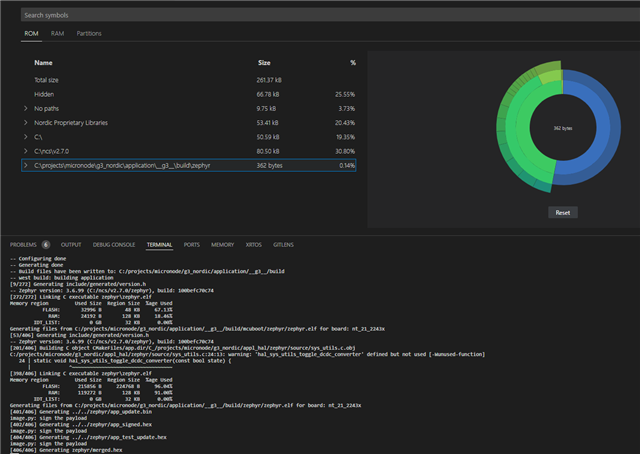

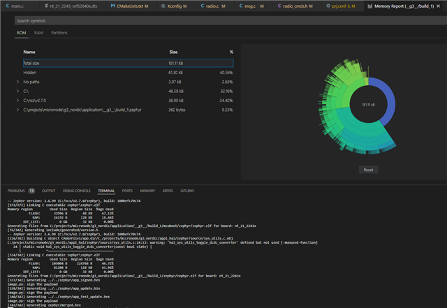

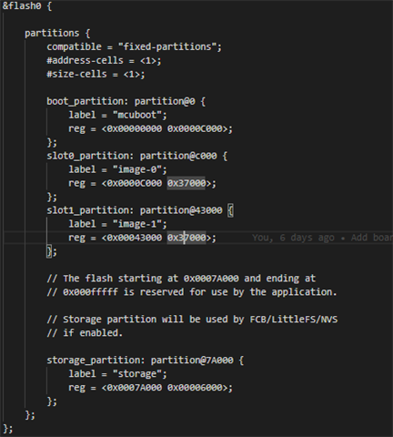

    5) I still doesn't understand memory report, I will give example for NRF52833, I added some features and now after compilation I have flash usage 215856B without mcuboot which takes 32996B, I run arm-zephyr-eabi-size command and get total size of merged.hex file of 249700B which is about main app + mcuboot, but memory report shows total size of 261,37kB so can you explain how this memory usage is calculated ? Here are screens of the memory report, flash partitions configuration.
    The memory report in nRF Connet for VS code is  a graphical representation of the Zephyr memory reports, so you can look into that if you want to understand the details. In practice this is used for optimization, but to see the actual size of your binaries, you shoudl look at the hex files which is the real end result.
