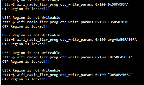

After that, I tried writing a command to unlock the OTP:
wifi_radio_ficr_prog otp_write_params 0x100 arg=0x50FA50FA
Unfortunately, the issue now is that it writes 0 to all the registers and locks the OTP. The output shows:
rtt:~$ wifi_radio_ficr_prog otp_write_params 0x100 arg=0x50FA50FA
OTP Region is open for R/W
Finished Writing OTP params
rtt:~$ [00:48:13.181,640] <inf> otp_prog: Written REGION_PROTECT0 (0x100) : 0x0000
rtt:~$ [00:48:13.181,671] <inf> otp_prog: Written REGION_PROTECT1 (0x104) : 0x0000
rtt:~$ [00:48:13.181,671] <inf> otp_prog: Written REGION_PROTECT2 (0x108) : 0x0000
rtt:~$ [00:48:13.181,671] <inf> otp_prog: Written REGION_PROTECT3 (0x10c) : 0x0000
rtt:~$ rtt:~$ wifi_radio_ficr_prog otp_write_params 0x120 arg1=0x23f4a7f8 arg2=0x06ce
OTP Region is locked!!!
USER Region is not Writeable
I am now unable to unlock the chip because all the arguments are being sent as 0, no matter what I try to write.
I also tried this commands:
wifi_radio_ficr_prog otp_write_params 0x100 arg='0x50FA50FA'
wifi_radio_ficr_prog otp_write_params 0x100 0x50FA50FA
wifi_radio_ficr_prog otp_write_params 0x100 1358582010
For me the issue is that arg always equal to 0 if I send them over RTT.
For sending I use the J-Link RTT Viewer V7.94e
    The arguments should be passed like this: 'wifi_radio_ficr_prog otp_write_params 0x120 0x23f4a7f8 0x06ce', without 'arg1=' and 'arg2='. I see that the protection bits were set after you ran the 'wifi_radio_ficr_prog otp_write_params 0x100 arg=0x50FA50FA' command, which unfortunately means the FICR can no longer be updated. Do you have another board you can test this on? Also, which SDK version are you on?
