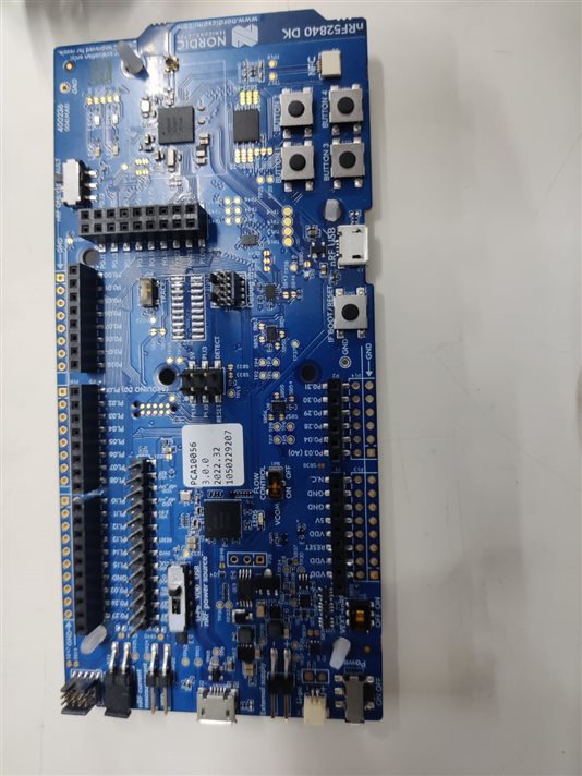

  • As i mentioned earlier im using v2.6.1 (both toolchain and sdk). I tried the default Helloworld sample but didnt see any output till i put the print statement inside a loop. im attaching a picture of my DK
  • Hi Kevin,
    Could you put the SW9 to VDD? Also make sure that SW10 is in the OFF position.
    You are trying the default hello_world sample in ncs\v2.6.1\zephyr\samples\hello_world right?
    I tried to reproduce it but could not. Please try building with the changes to the DK as mentioned above and let me know how it goes.
    -Priyanka
  • Instead of using the usb I used a usb to ttl converter and connected the tx rx pins and it works properly. I'm still not able to get data from connecting usb directly to dev board
