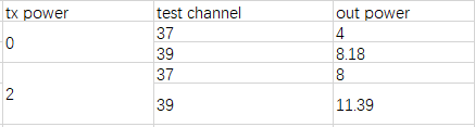

During the testing of nrf21540DK conduction power, a strange phenomenon was encountered: in DTM testing, when the transmission power was set to 0dB, there was a significant difference in conduction power between channels 37 and 39. The conduction power of channel 37 is 4dB, and channel 39 is 8dB. Why is that?
The DTM example I am using is nRF5_SDK_17.1.0_de560 \ examples \ dtm \ direct_test_made \ pca10112
The test results are as follows:

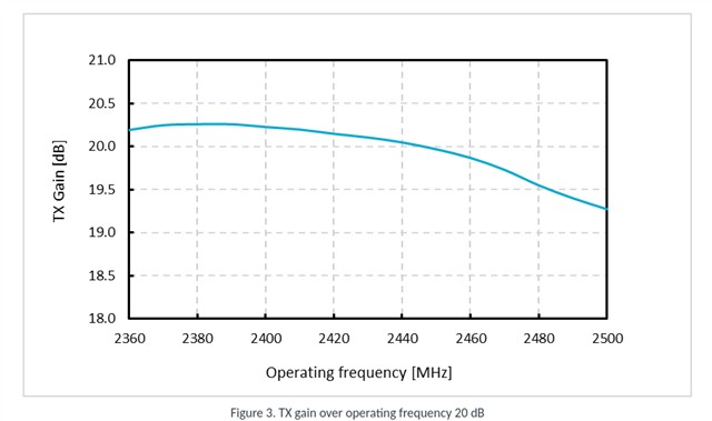

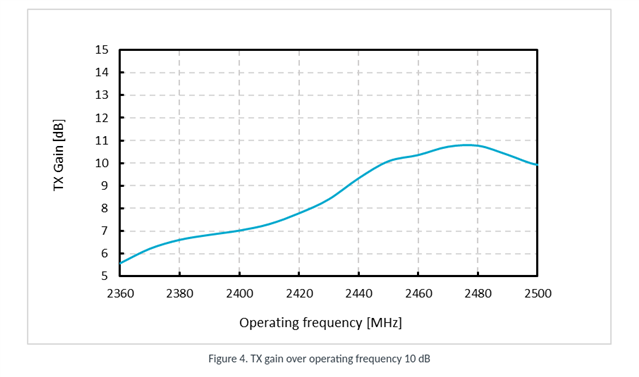

    The nRF21540 does not have linear TX gain over the 2.4GHz frequency band:
    These plots are for the default 20 and 10dB gain settings using the MODE pin.
    What does tx_power 0 and 2 refer to? output power from the SoC?

  • 1.These plots are for the default 20 and 10dB gain settings using the MODE pin.
    the MODE pin is setting to 1,use default  10dB gain.
    2.What does tx_power 0 and 2 refer to? output power from the SoC?
    yes,it from soc output power
