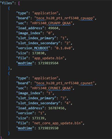

Hi there
My costumer was not able to update the cpunet on a nRF5340.
A lot of troubleshooting now led to the insight, that the costumer used only the app_update.bin file and not the complete .zip folder.
Is there a way to forbid the update on the nRF5340 when the net_core_app_update.bin is missing (so when the app is not using the .zip-folder)?

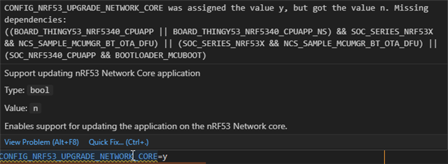

  • Hi Einar
    Thank you for your response.
    When I put CONFIG_NRF53_ENFORCE_IMAGE_VERSION_EQUALITY=y in child_image/mcuboot/prj.conf, it says that CONFIG_NRF53_UPGRADE_NETWORK_CORE=y is missing:
    But when I put CONFIG_NRF53_UPGRADE_NETWORK_CORE=y also in child_image/mcuboot/prj.conf, it says that further depedencies are missing:
    If I look into the build/mcuboot/zepyhr/.config:
    CONFIG_SOC_NRF5340_CPUAPP=y but CONFIG_BOOTLOADER_MCUBOOT is not present

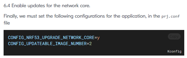

    And here https://academy.nordicsemi.com/courses/nrf-connect-sdk-intermediate/lessons/lesson-8-bootloaders-and-dfu-fota/topic/exercise-3-fota-over-bluetooth-low-energy/ in Step 6.4 it says that CONFIG_NRF53_UPGRADE_NETWORK_CORE=y goes into the main prj.conf
    Can you help?

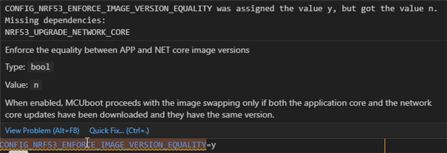

  • I have set CONFIG_NRF53_ENFORCE_IMAGE_VERSION_EQUALITY=y in  child_image/mcuboot/prj.conf.
    In the main prj.conf it is not set.
    The compiler gives the warning
    warning: NRF53_ENFORCE_IMAGE_VERSION_EQUALITY (defined at
    C:/_dev/_lib/ncs_2_6_1/nrf\subsys\bootloader/Kconfig:257) was assigned the value 'y' but got the
    value 'n'. Check these unsatisfied dependencies: NRF53_UPGRADE_NETWORK_CORE (=n). See
    http://docs.zephyrproject.org/latest/kconfig.html#CONFIG_NRF53_ENFORCE_IMAGE_VERSION_EQUALITY and/or
    look up NRF53_ENFORCE_IMAGE_VERSION_EQUALITY in the menuconfig/guiconfig interface. The Application
    Development Primer, Setting Configuration Values, and Kconfig - Tips and Best Practices sections of
    the manual might be helpful too.
    And the update still works with only the app_update.bin file (also with an old one)
