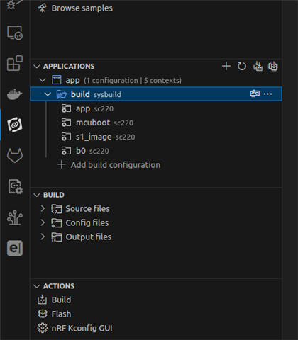

    I also have noticed (dunno if it's new or not) that now if in the nrf-connect extension page under applications -> app -> build i do not have debug, but if i go further to applications -> app -> build ->app (it's sys-build based west ws) then i do have both debug and debug with ozone, didn't test it yet but i have a hunch it will work, so if i'll update the runners yaml to include the zephyr rtos plugin it will work, ozone loads it automatically if it identifies rtos, so no need to update.

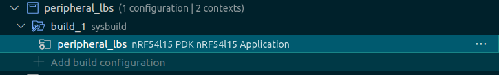

    It is similar to this, right?
    This is because sysbuild will append the image name inside the build-folder, as opposed to the partition manager.
    So now it will be build/$(IMAGE_NAME)/zephyr/ where the build files are located, as without sysbuild it is build/zephyr/
    Håkon
  • this is my setup, as yu can see when i'm on "app" i can see just build\flash operations, but if i go to a specific domain i can do more.
