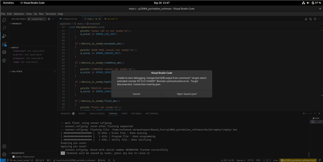

Hello everyone,
I'm currently working on a project wherewe use the ANNAB402 and Zephyr as out RTOS. We are developing using VSCode on a Linux VM. With a new board from us we had the problem, that the debugger of VSCode would not start anymore. We figured out, that on the previous version of the board we had an external pull-up resistor on the nRESET pin. Because of space on the board this resistor was removed, as was believed, that the nRESET pin would have internal pull-up activated by default.
I have tried to enable the internal pull-up in my overlay file, I was however unsuccessfull in getting the debugger to work. I would appreciate any help in trying to solve this through software implementation.

  • Hi, sorry for the late reply.
    1) yes, the VDD is 1.8V
    2) I tried to debug it trhough the nrf Connect extension for VS Code ("Actions->Debug")
    3
        // Use IntelliSense to learn about possible attributes.
        // Hover to view descriptions of existing attributes.
        // For more information, visit: https://go.microsoft.com/fwlink/?linkid=830387
        "version": "0.2.0",
        "configurations": [
                "type": "nrf-connect",
                "request": "launch",
                "name": "Launch the active build configuration",
                "config": "${activeConfig}",
                "runToEntryPoint": "main"
    4) We have different Evalboard, with a different Layout. That board is working. I also tested a few boards of the same type, that I got this problem on and 1 also had this problem, 1 had this problem but after a paatch with an external pull-up resistor it worked and I also had one, that could start the debugger without the patch of the external pull-up.
    We believe, that it might be a hardware issue rather than a code issue. So we will continue to test it and I will comment here, when we hopefully find the problem.
