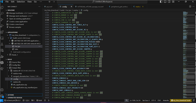

    We are working with both BLE and Wi-Fi in our projects. Initially, we faced an issue, but we resolved(Case link) it by adding the CONFIG_CLOCK_CONTROL_NRF_K32SRC_RC configuration in the network core via the hci_ipc.conf file.
    However, after including DFU, the same issue has resurfaced.
    Then I suspect that you do not configure the same clock source in the bootloader? If the bootloader? As these are separate images, you need to configure the correct clock source in all. Also, clock configuration is handled by the applicaiton core, so you only need to specify the source there (but in all binaries that run there and use the LF clokc source, which typically means MCUboot and your application).

    Here I share the mcuboot conf files, build logs and generated .config of network.

    Output config file of network core
