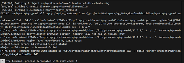

    To get network core log, include below config
    CONFIG_LOG=y
    CONFIG_USE_SEGGER_RTT=y
    CONFIG_LOG_BACKEND_RTT=y
    CONFIG_LOG_BACKEND_RTT_BUFFER=2
    CONFIG_BT_LOG_LEVEL_DBG=y
    But facing RAM and flash overflow
