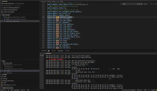

I'm attempting to build the aes_gcm sample using NCS 2.4.2 for a custom board with an nRF9160. However, I can just build the project for the nrf9160dk_nrf9160_ns target since no peripherals are required. The project builds properly as is and runs, but the operation to generate a random key (psa_generate_key) fails with error PSA_ERROR_NOT_SUPPORTED. This makes sense since I've read in other support threads that having CONFIG_TFM_PROFILE_TYPE_MINIMAL or CONFIG_TFM_PROFILE_TYPE_NOT_SET set in prj.conf essentially gets the project to build with tfm but crypto operations will be significantly limited or unavailable. When I attempt to set CONFIG_TFM_PROFILE_TYPE_MEDIUM, nothing is printed out to the console. Any suggestions as to what could be going wrong?
    I was not able to reproduce this with SDK v2.4.2 and a nRF9160DK (build target nrf9160dk_nrf9160_ns).
    Here's the the generated configuration file (build/zephyr/.config) from my build:

    After looking at the diff, the only differences I notice are our toolchain paths and our logging setup.
    I built the project using this command:
    west build -b nrf9160dk_nrf9160_ns --pristine
    and flashed it like this:
    (nrfjprog -f NRF91 -e && nrfjprog -f NRF91 --program build/zephyr/merged.hex --verify && nrfjprog -f NRF91 --pinreset)
    Also, I see that you built the sample with NCS v2.5.0. Does that matter?
    Another note, I'm seeing this warning during build
    -- Found assembler: /home/ethan/zephyr-sdk-0.16.0/arm-zephyr-eabi/bin/arm-zephyr-eabi-gcc
    CMake Warning at /home/ethan/fw-dev/v2.4.2/zephyr/CMakeLists.txt:839 (message):
      No SOURCES given to Zephyr library: lib__libc__common
      Excluding target from build.
  • Ok I'll try that. Can you give me an example of disabling crypto services? It's confusing to me which config variables actually enable/disable various crypto operations
  • I have experimented with this but have been unable to reduce it to the required size. Below are the configurations I tried, but the FLASH footprint was still around 66kB.

    $ arm-zephyr-eabi-size build/tfm/bin/tfm_s.elf
     text    data     bss     dec     hex filename
      66044     392   52100  118536   1cf08 build/tfm/bin/tfm_s.elf
    I have asked the developers if there are additional optimizations we can do and I'm awaiting their feedback.
    Sorry for the delayed response. Unfortunately, even with help from R&D, I haven't been able to reduce the flash footprint of the TF-M image enough to fit into your existing SPM partition. That said, since the TF-M and app binaries are uploaded as a single image, you should be able to allocate more flash to the TF-M without affecting the memory layout of the MCUboot slots.
  • That's great news Vidar! I have one more question so that I can understand how everything works correctly. My understanding is that MCUBoot is the first application run since it's at memory address 0x0. Then, MCUBoot boots into TF-M which prepares secure peripherals if they're enabled and secure regions of memory. Then, TF-M boots into my application, and any time my application makes a crypto call, the context switches to the TF-M application so that it can perform the crypto operation securely. Is that all correct? And because MCUBoot only jumps into TF-M and not my application, the main thing that matters in my pm_static.yml file is that TF-M is placed at the same address that SPM was?
