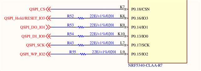

nRF5340 and W25Q512NW Nor Flash R/W problem?
I am using W25Q512NW (https://www.winbond.com/resource-files/W25Q512NW%20RevB%2007192021.pdf) in my custom board. I want to store the sensor data in this flash.
My custom board use the nRF5340 MCU and the version of the nrf connect sdk is V2.5.2.
the problem i am facing that i am not able to read the data from the flash.
*** Booting nRF Connect SDK v2.5.2 ***
[00:00:00.252,868] <inf> main: iMedrix External flash Application Started.
Device name: w25q512nw@0
Data written. Good!!
23 22 33 44 55 66 77 88
Data read. Good!!
FF FF FF FF FF FF FF FF
Data not matched..!!
JEDEC ID : EF  60  20
In above log, i am writing 8 bytes and also read those 8 bytes. but when i read data from the flash i am getting only FF.
And when i read the JEDEC id of the flash, i am getting right JEDEC id.
Here is the prj.conf file.

Here is the .overlay file below.
&qspi {
	status = "okay";
	pinctrl-0 = <&qspi_default>;
	pinctrl-1 = <&qspi_sleep>;
	w25q512: w25q512nw@0 {
		compatible = "nordic,qspi-nor";
		reg = <0>;
		/* MX25R64 supports only pp and pp4io */
		writeoc = "pp4io";
		// writeoc = "pp4o";
		/* MX25R64 supports all readoc options */
		readoc = "read4io";
		sck-frequency = <8000000>;
		// jedec-id = [c2 28 17];
		jedec-id = [EF 60 20];
		sfdp-bfp = [
  			e5 20 fb ff  ff ff ff 1f  44 eb 08 6b  08 3b 42 bb
  			fe ff ff ff  ff ff 00 00  ff ff 40 eb  0c 20 0f 52
  			10 d8 00 00  33 02 a6 00  81 e7 14 d9  e9 63 76 33
  			7a 75 7a 75  f7 bd d5 5c  19 f7 5d ff  e9 70 f9 a5
		size = <536870912>;
		// address-size-32;
		has-dpd;
		// t-enter-dpd = <10000>;
		// t-exit-dpd = <35000>;
		t-enter-dpd = <3000>;
		t-exit-dpd = <30000>;
Please give me your suggestion in this.
Let me know if any modification is required.
Thank you in advance.
Gautam.
  • Hi
    It seems you're just reading empty data from what I can see here, so can you confirm that you're reading the same addresses as you're writing to in your application? What driver APIs and functions are you using for reading and writing to the external flash exactly here?
    Simon
  • Hello  ,
    Thanks for the ans.
    Yes,   i already confirm that i reading the same addresses as I writing to in my application.
    - I am using flash API.

    What API is this exactly? Does it support QSPI, because I think the nrfx_qspi driver should be used for this instead of a generic flash API. I don't see any mentions of QSPI here in the snippet you uploaded.
    Simon
    I follow the QSPI Example given in the NRF Connect SDK which is spi_flash (https://github.com/nrfconnect/sdk-zephyr/tree/main/samples/drivers/spi_flash).
    T
    his example works good with the external flash (MX25R6435F) which is placed on nRF5340DK.
    I use the API for qspi which is used in above example code.
    And also I interface my external flash using QSPI with the nrf52840 and nrf5 SDK, And there also result is same.
    Thanks & Regards
    Gautam
  • Hi
    Hmm, okay. What pins are you using for QSPI on your custom nRF5340 board here. How exactly are the nRF5340 and W25Q512NW flash connected here, and what voltage are you supplying the nRF5340 and external flash device wtih.
    Simon
