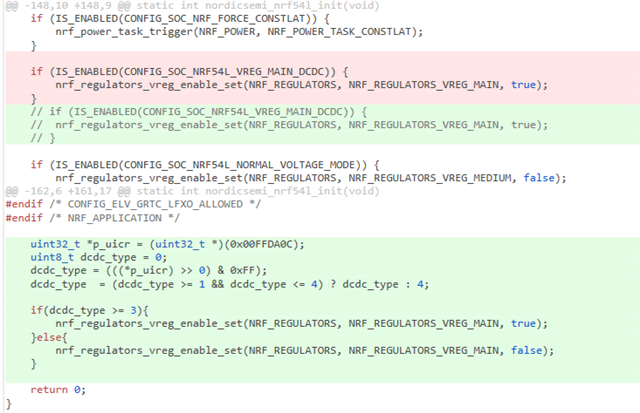

        We know whether the board has LFXO and dcdc, so we can burn the parameters into UICR first when burning and then use uicr param set param.
    Is it possible to reconfigure parameters during initialization?
    If this is really not possible, I can also use your answer to convince my boss to make multiple firmwares for adaptation.
    Thanks
    I see. If you can check in UICR, then you can make a decision based on UICR content. This is not directly supported, but you can modify power_and_clock_configuration() in zephyr/soc/nordic/nrf54l/soc.c (this is part of the SDK and is expected to change going forward).
    When it comes to clcok control this is also a decition made by Kconfig during build and in code it id used by the Zephyr clock control driver in zephyr/drivers/clock_control/clock_control_nrf.c and when initializing MPSL in nrf/subsys/mpsl/init/mpsl_init.c. I see no direct techincal reason why you cannot modify this to do it dynamically, but it will require some changes to the SDK that you will have to handle and maintain over time.
    I would argue that using separate board fiels and/or overlay files for separate HW variants is cleanest, and that is how this is intended to be handled.

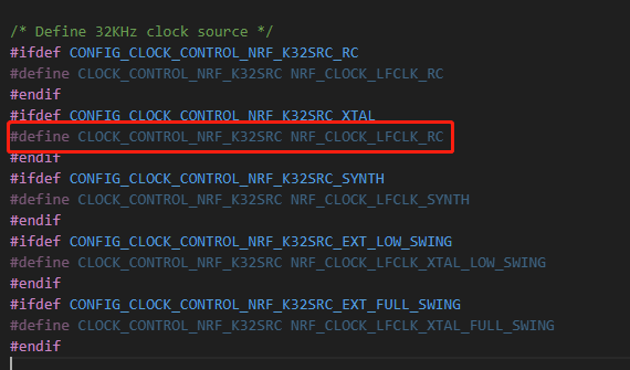

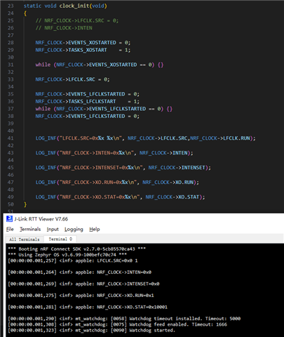

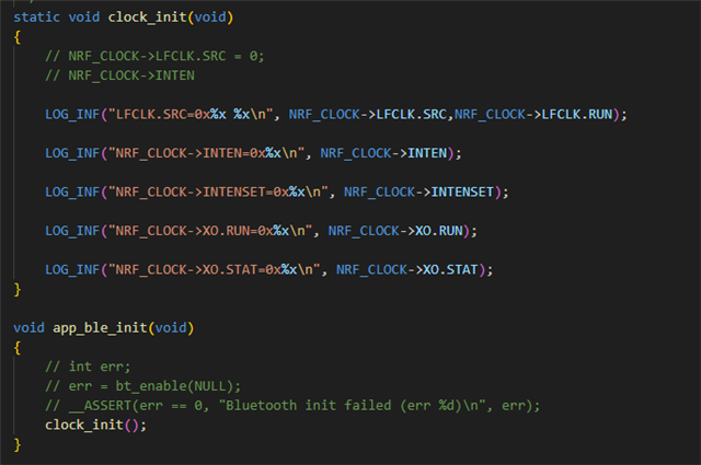

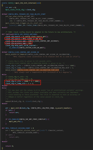

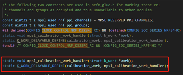

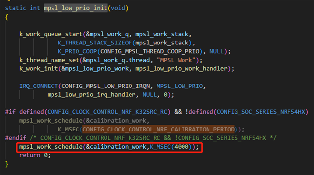

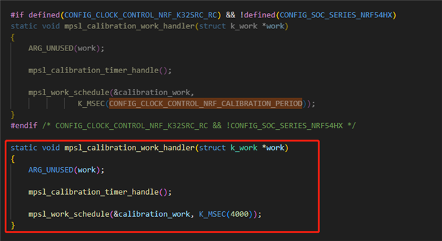

    Here are my steps.The purpose is to try to use RC in XTAL mode, but it can't work.
    ncs2.7.0
    board: nrf54l15
    1. prj.conf
    2. Change mpsl_init.c
       2.1 mpsl_lib_init_internal
      2.2 mpsl_calibration_work_handler
    2.3 mpsl_low_prio_init
    3. change nrf_clock_control.h

    I am not sure what you are attempting to show by the code snippet screenshots?
    As discussed earlier, switching clock source compile time is supported, and that is handled by Kconfigs. There are other relevant configs, but the most important it to set CONFIG_CLOCK_CONTROL_NRF_K32SRC_RC=y to use the RC and CONFIG_CLOCK_CONTROL_NRF_K32SRC_XTAL=y to use the xtal. This should wrok out of the box on any device wihtout needing to do any code changes. Does it not for you?
    Or are you starting to work on a way to modify the LF clock source run-time? If so, that is not supporte dand would requier changes (I also suspect it may get a bit dirty as this was never designed to be run-time configurable). If this is what you are doing and are having problems, then please share your changes in form of a diff or similar and explain the thinking behind it and how it behaves, so that I can try to understand on my end and perhaps provide some clues.
        Thanks for your response. We have decided to use the method you provided to make two firmware.
