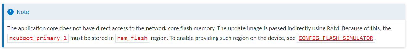

Hello, acording to the Simultaneous multi-image DFU documentation a RAM section is needed to act as a flash simulator during the network core update.
Is this RAM section only allocated by MCUboot during the upgrade procedure or is it statically allocated during normal operation of the application core?
I want to know if this ram_flash section is consuming resources of my application.
