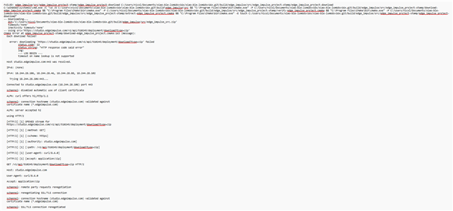

I am trying to use the Edge Impulse integration on a Seeed Studio Xiao BLE Sense (nrf52840 based). When I manually download the zip file from Edge Impulse and specify its location using the CONFIG_EDGE_IMPULSE_URI it works fine.
I now want to be able to download my Edge Impulse private project automatically, which seems possible according to the documentation (https://docs.nordicsemi.com/bundle/ncs-latest/page/nrf/external_comp/edge_impulse.html#downloading_from_a_private_project), but I cannot get it to work.
I follow the documentation's steps regarding CONFIG_EDGE_IMPULSE_URI, and I build my application with west build -b my_board -p=always my_app -- -DEI_API_KEY_HEADER="x-api-key:my_key", but I get the following error:

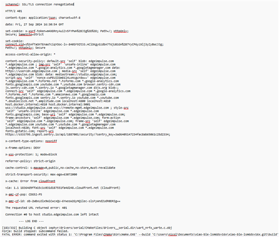

I also tried the individual call using Edge Impulse's documentation: https://docs.edgeimpulse.com/reference/edge-impulse-api/deployment/download
After clicking on "Test it", if I add my project ID, and add a header with key x-api-key and value my_key, the request successfully completes.
Do you have an idea on what I can do to solve the issue please ?
