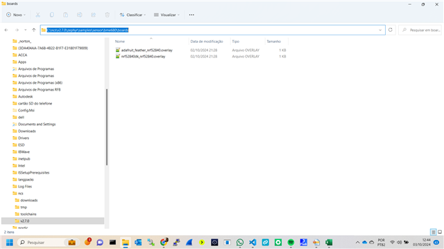

    When you see an error please try to debug. The last line is:
    C:/nordic/myapps/bme680/src/main.c:14:42: note: in expansion of macro 'DEVICE_DT_GET_ONE'
    14 | const struct device *const dev = DEVICE_DT_GET_ONE(bosch_bme680);
    Device tree having trouble finding the bosch_bme680 device. Have you checked if you define the i2c node that compatible with the bosch_bme680 ?
    Please take a look at the boards\nrf52840dk_nrf52840.overlay in the bme680 sample.
