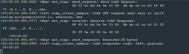

I am running CoAP client with DTLS enabled on an nRF9161dk.
I poll socket using this code:

I am able to receive data (POLLIN), but when server closes session and sends close_notify, I am not able to receive POLLHUP.
I've tried nRF SDK 2.6.1 and 2.7.0. Modem FW version: mfw_nrf91x1_2.0.1.
Has anyone else encountered this problem?
