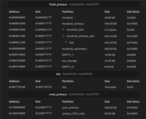

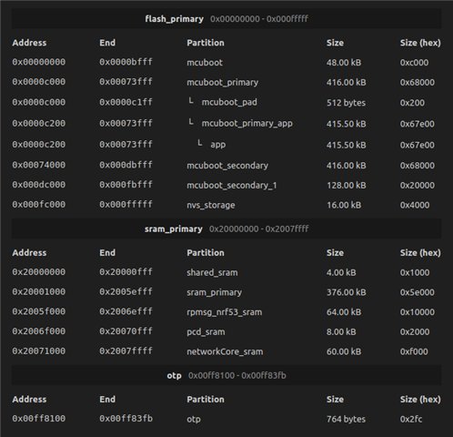

Hello I'm trying to do an static partitioning scheme using a pm_static.yml file and also I want to use NVS to store some data.
The problem is that when I add NVS to the project a nvs_storage partition is automatically generated inside mcuboot_primary_app and I don't want that, I want a separate partition for NVS  (storage1) because I'm going to do DFU and I dont want to lose that data on every DFU process.
What can I do to delete nvs_storage partition?
This is my pm_static.yml

And this is the generated memory report:
Regards!
