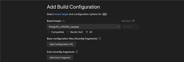

I am building the existing WIFI station app for the Thingy53 with the nRF 7002EB board - sample code: nrf/samples/wifi/sta
In the CMakeLists.txt file, the line CONFIG_WIFI_READY_LIB=y is throwing me the error: attempt to assign the value 'y' to the undefined symbol WIFI_READY_LIB
I have tried to build the application with toolchain v2.6.0 and v2.7.0, with the board target being thingy53_nrf5340_cpuapp and thingy53_nrf5340_cpuapp_ns, adding the additional CMake argument of -DSHIELD=nrf7002eb to to configuration.
All of these options have resulted in the Fatal error.
How do I get the config_wifi_ready_lib to integrate in my workspace?

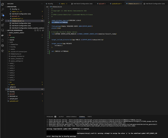

    With sysbuild enabled, one has to add the image name, ie. -DstaSHIELD=nrf7002eb.
    It is then easier to set this in your CMakeLists.txt:
    # Copyright (c) 2022 Nordic Semiconductor ASA
    cmake_minimum_required(VERSION 3.20.0)
    set(SHIELD nrf7002eb)
    ...rest of file
    Could you try this and see if that works?
    Håkon

  • Hi Jon,
    This is the build cmd that vscode emits when I set the SHIELD in CMakeLists:
    west build --build-dir /opt/ncs/nrf/samples/wifi/sta/build /opt/ncs/nrf/samples/wifi/sta --pristine --board thingy53/nrf5340/cpuapp --sysbuild
    And this is without setting it in CMakeLists.txt, and instead add it as a parameter:
    west build --build-dir /opt/ncs/nrf/samples/wifi/sta/build_1 /opt/ncs/nrf/samples/wifi/sta --pristine --board thingy53/nrf5340/cpuapp --sysbuild -- -Dsta_SHIELD=nrf7002eb
    Where did you place the set(SHIELD line in your CMakeLists.txt file? It is crucial that it is placed before this line:
    Håkon
  • Hi Hakon,
    The set(Shield) line was place directly after the cmake_minimum and before the find package, sadly. The error is still occurring
    What I noticed was different, was the build target. My SDK is targeting the following - would this create a discrepancy?

    Can you share your full cmake configuration + build log? Are you building for NCS v2.7.0 or v2.6.2?
    The WIFI_READY_LIB was not present in v2.6.1 (and older), so that might explain why you are still seeing this issue.
    Håkon

  • Hi Jon,
    Based on the zephyr version:
    -- Zephyr version: 3.5.99 (/Users/jon/Documents/smartweight_project/workspace/zephyr)
    This indicates that you're on v2.6.1 or older.
    Can you try running this on ncs v2.7.0 ?
