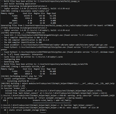

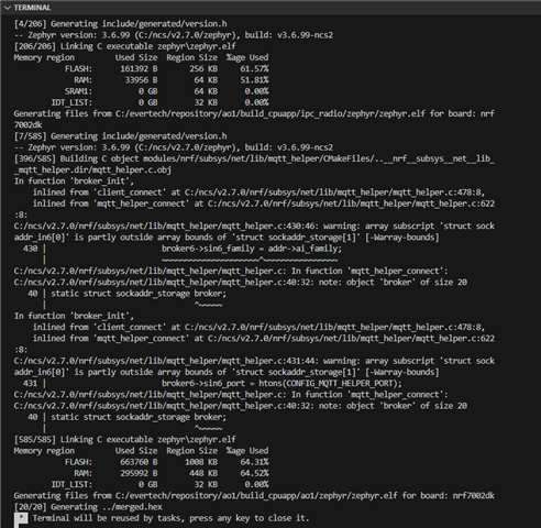

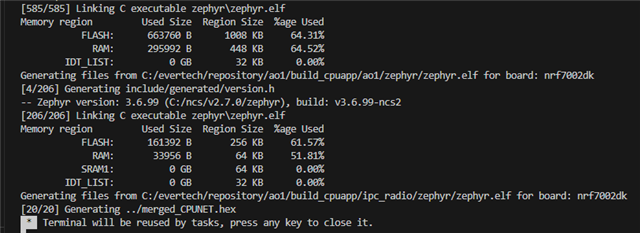

    How much RAM and flash is used by the application? You should see this close to the end of the build log. Please make sure to share all instances of this from the build log, or share the complete build log.
    using nrf7002dk/nrf5340/cpuapp build target
    The AWS IoT sample supports board targets with the */ns variant, i.e. nrf7002dk/nrf5340/cpuapp/ns. Trying to use the code without /ns might cause issues.
    Marte
  • Hi Marte,
    Here's the build logs for the cpuapp showing RAM and Flash usage:
    And for the cpuapp_ns build:
    However when I run the cpuapp_ns build, I hit a SECURE FAULT when attempting to connect to AWS:

  • Update: I was able to get the nrf7002dk/nrf5340/cpuapp/ns build target working after creating a pm_static.yml file to address the "TF-M non-secure start address is not aligned to SPU HW requirements" error. It was off by 0x200. Now using the non-secure build I'm still hitting the same mqtt_connect, error: -123
