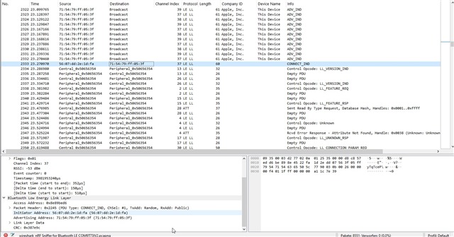

I am using Wireshark 4.4.0 and Nordic nRF Sniffer for Bluetooth LE 4.1.1 (nRF52840-Dongle PCA10059). In Wireshark I see a device, a peripheral, sending advertising packets, and when I connect to the peripheral with my phone using the nRF app, the packets related to the connection often do not appear in Wireshark. Sometimes they do, sometimes they don’t. see the attached Image as an Example where everything works fine.
It seems as if Wireshark sometimes fails to switch from the advertising channels 37, 38, 39 to the connection channels.

    Have you followed all the steps mentioned in setting up the nRF BLE sniffer? As a reference, you can go through this chapter to ensure everything is set up correctly. Regarding the image you shared, it’s too small, and when I tried to zoom in, the image became blurry as it is not of high quality. Could you please try sharing a clearer image that shows the issue properly?

    The original image is large enough: 1538x664, but whenever I copy it here via drag and drop, it seems to get smaller.

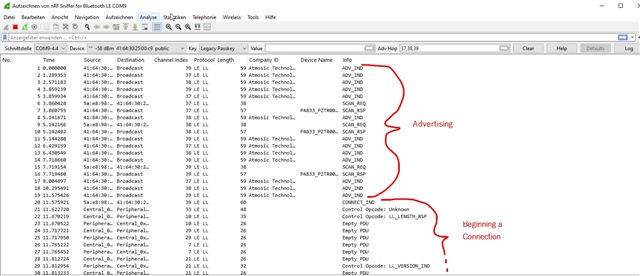

    In the image, I see a CONNECT_IND packet at timestamp 10.259491, which signals the beginning of a connection. Ideally, the sniffer should switch from advertising channels to data channels at this point. However, the following packets show "Empty PDU," indicating that the sniffer didn't successfully follow the connection.

    You can see the ‘Empty PDU’ packets repeatedly, see the attached Picture, I always explained this to myself as the keep-alive signals, similar to a heartbeat function.
