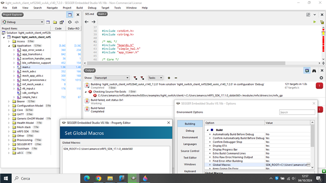

Getting error: board.h and other header no such file or directory. with nRF5_SDK_15.0.0_a53641a and nrf5sdkformeshv500src in the same path.
What could it be?
The evaluation board is nRF52833 purchased by Mouser.
Thanks in advance,
Antonio

Hi Antonio,
Please be aware that it's not recommended for new development to start with NRF5 SDK and nRF5 SDK for Mesh. These SDKs have been put on "maintenance mode" for very long time (since 2020). For new product development please use nRF Connect SDK. The mesh stack and samples are provided in the new SDK as well.
If for some reason you have to use nRF5 SDK for mesh , please show us a full log or the screenshot of the error. Make sure you set the SDK_ROOT to the correct path to the nRF5 SDK (the main SDK not the mesh one). Take a look here: docs.nordicsemi.com/.../md_doc_getting_started_how_to_build.html
Hi Hung,
i attached the print screen of the error.

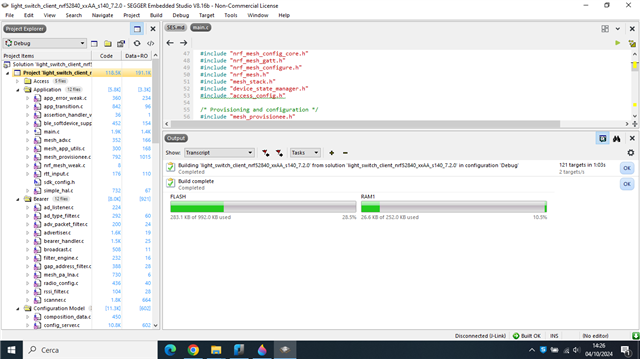

Hi Antonio,
Glad that it build now. Have you tried to follow the documentation ? https://docs.nordicsemi.com/bundle/nrf5_sdk_mesh/page/md_examples_light_switch_README.html
