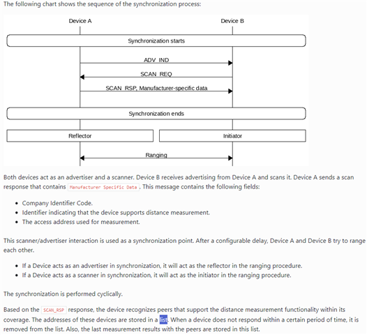

1 - If we have more than 2 boards, the ranging works fine for a while (1-5-10 minutes) - in that time we got distances between a "locator" and random "raflector", and "reflectlor" seems to be random - so it is fine, we got the distances to all of the reflectors. But after a while the "locator" boards seems to "lock" on some particular "reflector" board (most often on the nearest one). After this "locking", we got only distances to one reflector board. If we move the locator close to other reflector, if will "relock" after a while to the currently physically closest one, and will measure the distance only to that one. So if we have, for example, 3 "reflectors" and one "locator" - we will only have a distance to one "reflector".
Resetting the "locator" board solves this for a while, but then the situaltion repeats. It seems like there is some implicit synchronization between scan cycle of "locator"'s Softdevice and "reflector"'s Softdevice advertisements.

    Both devices act as an advertiser and a scanner at first in the sample. This scanner/advertiser interaction is used as a synchronization point. After a configurable delay, Device A and Device B try to range each other as reflector or initiator. The scanner would store the addresses of the supported devices in a list.
    Is there some config option for defining a board role (initiator/reflector)?
    There is no specific config to assign an initiator/reflector role in the DM sample, but you can modify the sample to achieve that.

    If the device does not act as a scanner it does not build the list of supported peers.
    In the DM sample (from NCS) the device acts as both scanner and advertiser. A list of supported device is build in the scanner callback function. This list is only used for the purpose of sample. It is not used by the dm submodule or the nrf_dm library.
    Note: the current application is not designed to support a large number of units. That will require some changes to the application layer to make it more stable. This has not been in scope for us and it is up to the customer to implement.

    The sample is optimized for one-to-one measurements. If you are doing multiple units, we recommend you build some kind of scheduling solution into the application layer.
