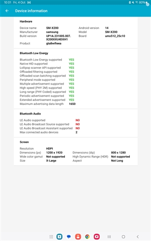

Galaxy Tab A8 fails to connect properly, while Galaxy Phone S10 works fine
Galaxy Tab A8 connects, but then disconnects after a burst of approx 600 "Central_0x2a208f55 Peripheral_0x2a208f55 ATT 37 Sent Read By Group Type Request, Primary Service, Handles: 0x0001..0xffff"
Galaxy S10 works fine
Bot are running the same mobile app.
I have attached 2 Wireshark capture files, one for Samsung Galaxy Tab A8, the other for Samsung Galaxy S10
We use ncs 2.6.1 on our nRF52840 hardware
