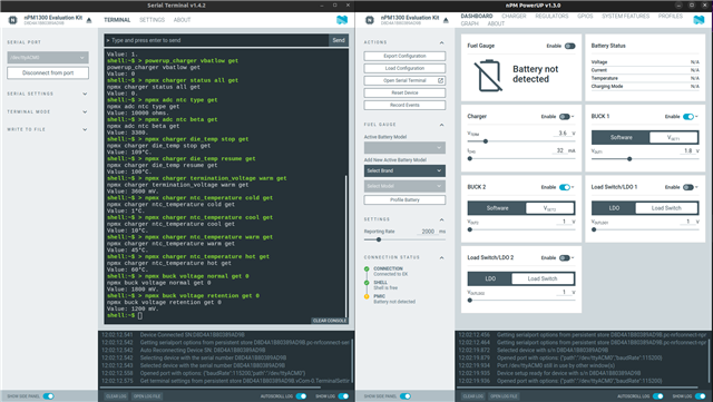

i'm developing a custom board with nPM1300 + nrf5340. First things first, i purchased a nPM1300-EK to acquire the needed knowledge to make things working. Unfortunately, i'm having troubles starting to work with it. Summarizing, my issue is that nPM PowerUp (v.1.3.0) is staying in "Offline Mode" no matter how hard i try.
SETUP:
1) For my experiments, i'm using a Li-Ion battery 3.7-4.2V, 1100mAh, with no NTC
2) The battery is connected through P1 and having no NTC i used a jumper on P3 between NTC and 10kOhm pins. Wires polarization has been double-checked.
3) I followed the boot-strap sequence: USB-C on PMIC -> Battery connection -> USB-C on nPM controller as described here
4) Using a digital multimeter i can detect VOUT1=1.8V and VOUT2=3V. This is a good check for USB-C on PMIC and for the PMIC health status itself.

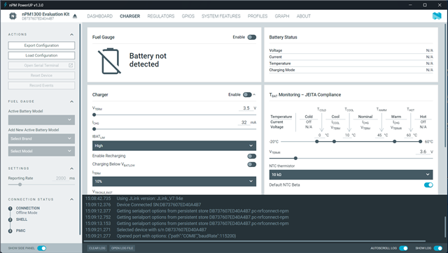

5) When nPM controller USB is plugged i get the popup on the PC and the devices pops in nPM PowerUP too. This is a good check for USB-C on nPM Controller. The LD4 led blinks slowly (once every 2s more or less).
I can select the nPM1300 EK device on the nPM PowerUP software. When i do, the log displays these lines:
12:18:31.164	Selected device with s/n DB737607ED40A4B7
12:18:31.168	Opened port with options: {"path":"COM8","baudRate":115200}
Unfortunately, and this is the issue, on the left side the "Connection status" is highlighted as "Offline Mode", with no green color anywhere (as it happens here on your Youtube vid) For the very same reason, i can't set the charger or having any response from the software (i can edit values but nothing changes, so i suppose is a "don't care" edit).
Suggestions?

  • Hi Frax,
    Can you share a screenshot of the nPM PowerUp application and a picture of how you have connected things?

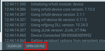

    Please also share verbose logs from the nPM PowerUp
    1. Go to the "About" tab in nPM Power Up
    2. Enable verbose logging
    3. Click "Restart with verbose logging"
    4. After nPM Power Up has restarted, select the nPM1300 EK device
    5. Share the log file here
    You can find the log by clicking on "open log file". Either copy the file's content and paste it using Insert > Code or upload it as a .txt file with Insert > Image/video/file.
    Marte
  • Hi Marte,
    thank you for your feedback. Here you can find attached the screenshot of my nPM PowerUp software AFTER i select the nPM1300 EK with the SELECT DEVICE button.
    Screenshot

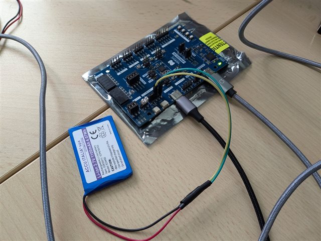

    Here the picture of my EK setup:
    EK SETUP
    Here above you can see the yellow (VBAT) and green (GND) dupont cable with the white jumper (NTC->10kOhm) and the two USB-C cables. No other jumpers were removed/added respect to the standard ones.
    Finally, as you asked, i leave attached the verbose log.

    If, without closing the Serial Terminal app console, i open the nPM PowerUp app:
    1) If i ignore the Select Device part of nPM PowerUp assuming that the device is connected...nothing happens, neither in nPM PowerUp console nor EK hardware (i.e. charging battery led doesn't light up) nor nPM options/plot
    2) If i Select Device in the nPM PowerUp part and select the EK the Serial Terminal app drops the connection and the same behaviour as before happens in the nPM PowerUp console:

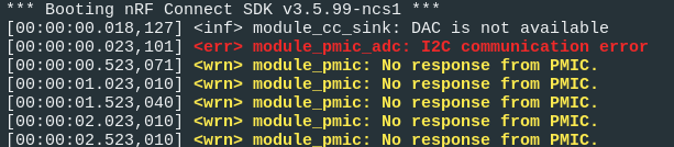

    1) USB PMIC -> NOT CONNECTED + USB NRF CONTROLLER CONNECTED
    *** Booting nRF Connect CDK v3.5.99-ncs1 ***
    K00:00:0 .023,437] <inf> modele_cc_sink: DAC is not available
    1;32m[00:00:00.028,381] <err> module_`mic_adc* I2C communication error
    1;32m[00:00:00.529,479] <wrn> module_`mic: No response from PMIC.
    [1;32m[0 :00:01. 28,289] <wrn. moduleOpmic: No response from @MIC.
    1;32m[ 0:00:01.528,320M <wrn> module_pmic: No response from PMIC.

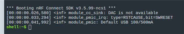

    2) USB PMIC -> CONNECTED + USB NRF CONTROLLER CONNECTED
    *** Booting nRF Connect SDK v3.5.99-ncc1 ***
    [1;32m[0 :00:00. 31,799] <inf> module_ccOsink: DAC is nod available
    [ 0:00:00.038,177M <inf> module_pmic_irq: type=RSTCAUSE,bit=SWRESET
    [1;32m[0 :00:00. 46,691] <inf> module_pmic: Defaelt USB !00/500mA
    1;32mchell:~$
    As you can see, the output you are interested is present in both situations.

    I see a similar output to your tests, except that some characters are incorrect in your log, e.g., @MIC instead of PMIC.
    However, when the nPM1300 EK is opened in the nPM PowerUp, you should start seeing shell commands similar to this in the serial terminal:
    I am not sure why this is not happening in your case, but we are still investigating it.
