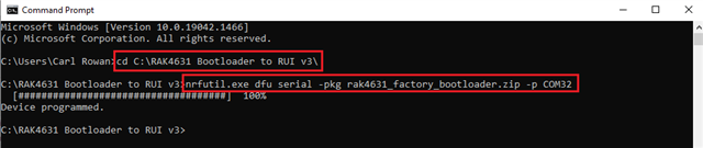

As a alternative, I would like to work with the nrfutil like this RAK example, via USB port: “nrfutil.exe dfu serial -pkg rak4631_factory_bootloader.zip -p COM5”.

  • In the RAKWireless environment, my normal procedures to recover or re-install the Arduino BSP environment, it is using "nrfutil" utility with "dfu" and "serial", and it works without problems.
    The procedure with RAK4631 is:
    1. RAK4631(nRF52840+Semtech LoRa SX1262) is working with Arduino BSP, then I do the Softdevice flash
    2. First, using USB port from RAK19007 mother board, I do the bootloader with the nrfutil: “nrfutil.exe dfu serial -pkg rak4631_factory_bootloader.zip -p COM5”.wouldn´t work for MCUBoot+Zephyr.

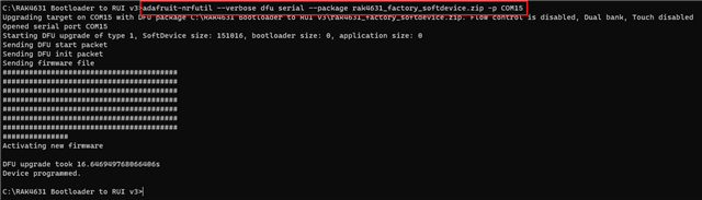

    3. After I flash the Softdevice: "adafruit-nrfutil --verbose dfu serial --package rak4631_factory_softdevice.zip -p COM15"
