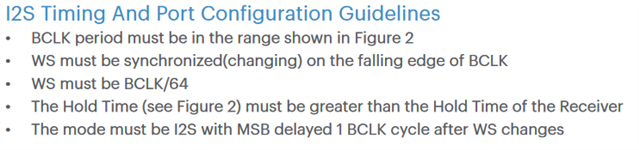

    Please check the that these requirements from the SPH0645 datasheet are met:
    The screenshot is from page 8.
    From the datasheet I found that having SCK/BCLK below 2.048 kHz is out of spec for the microphone.
    You can check the timings with a logic analyser, for example.

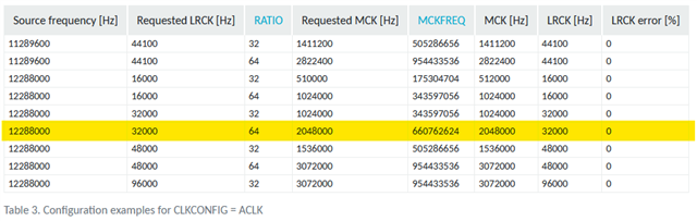

    Based on the datasheet for the SPH0645 and nRF5340 SoC, a possible configuration to use is marked in yellow here:
    The table is from the Configuration examples section of the I2S peripheral for the nRF5340.
    Maria

    I suspect the missing piece is to configure the MCK in the source code. This is not possible with the Zephyr I2S API, but can be done by setting the CONFIG.MCKFREQ register. You can compute the value with the MCKFREQ equation (Figure 3.) from the Master Clock section of the I2S peripheral and for fMCK = 1.024 MHz and fsource = 12.288 MHz the MCKFREQ value is 343597056 or 0x147AE000 this value can also be found in row four in the table I sent previously.
    Please see this reply from my colleague on a previous case for further considerations when configuring MCK.
    If you don't want to set the register directly you can use the nrfx: I2S driver to configure MCK. The result from the MCKFREQ equation is used as the mck_setup here as well, see the configuration from the nRF5340 Audio application here for reference.
