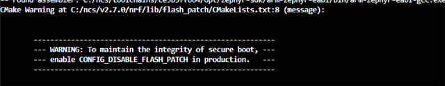

I have a BLE application where I want to use the device firmware updates (DFU) over Bluetooth. I followed the nRF Connect SDK Intermediate tutorial on how to enable the DFU. However, I got some warnings and errors along the way that I cannot resolve and also do not completely understand.
First warning:

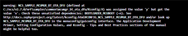

When I try to add the CONFIG_DISABLE_FLASH_PATCH flag to my prj.conf file as stated in this post (post2), it throws that the NCS_SAMPLE_MCUMGR_BT_OTA_DFU has the value "n":

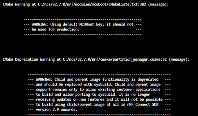

When I try to add the BOOTLOADER_MCUBOOT to my prj.conf it suddenly activates the old build process with child and parent image functionality.
What is correct approach here?
The second thing is that I want to add these flags to the mcuboot, but with sysbuid it does not recognise them:
The error:
How do I pass the correct the flags to mcuboot.conf?

    Thanks, the warning is gone. The solution is to add these two symbols to mcuboot.conf:
    ## Note that disabling flash patching also disables breakpoints.
    CONFIG_DISABLE_FLASH_PATCH=y
    CONFIG_REBOOT=y
    If I could read properly, it would be easy to fix. On the Nordic site, and also on other Zephyr sites, it is written what is expected:
    https://docs.nordicsemi.com/bundle/ncs-1.8.0/page/kconfig/CONFIG_DISABLE_FLASH_PATCH.html
    "expects REBOOT"
